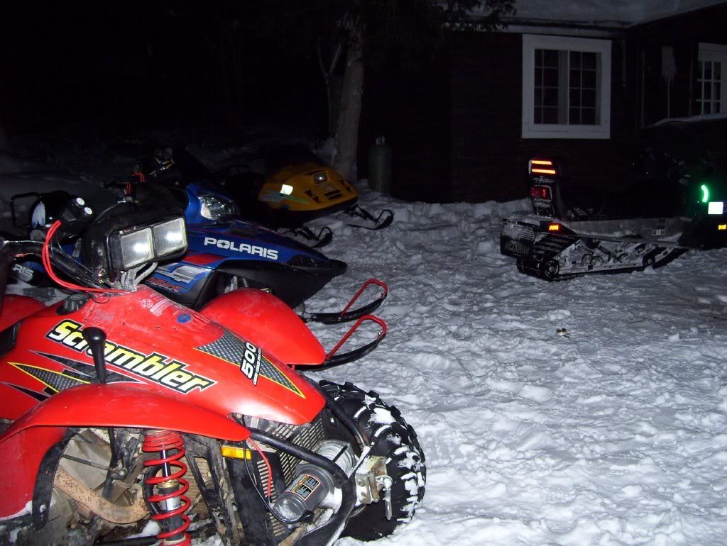

What is this winter storage of which you speak?
