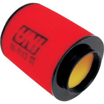

I looked into the K&N for my bike 05 Sp 500 and I decided to go with UNI filter instead. Great filter and easy to clean.
Attachment 5912
You picked the best filter for any atv! I've seen too much damage cause by neglected K&N filters,even with socks on they breathe in too much dust for off road use and goes straight to the piston.Uni is especially good for the old 2 strokes that are crucial on having clean air! That's why almost all 2 stroke dirt bikes have foam filters also! K&N is fine for cars on nice clean highways! I know others may disagree,but just from my experience and also just my OPT
Thanks Old Polaris Tech, my thoughts exactly!

K & N's do work great, but all it takes is ONE day of dusty conditions and your motor is hurt. Get a UNI.
