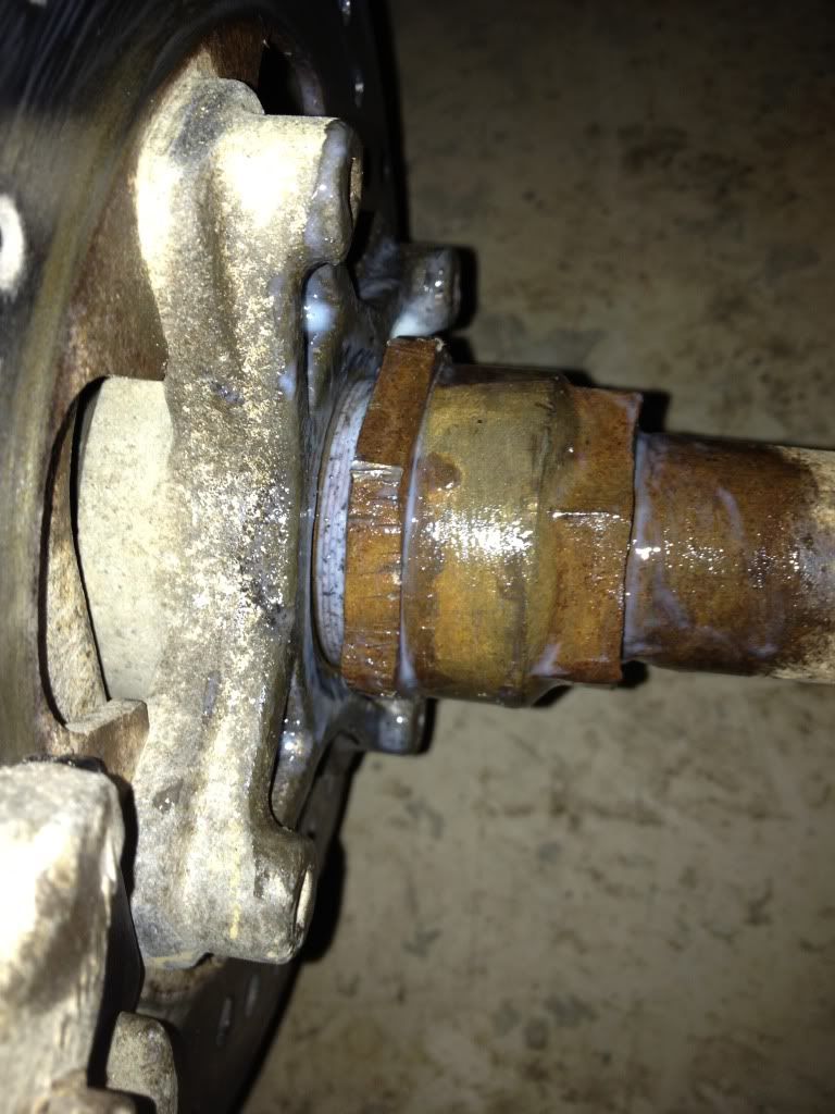

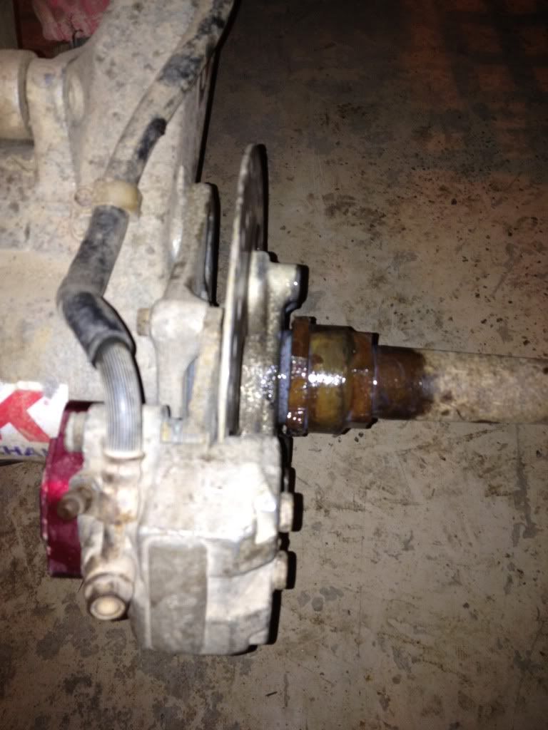

So I recently bought a 2001 400ex and I have been doing some small tlc here and there as I ride it. Just a few hours ago my dads friend said my axel nut was loose but there is no play in my axel, although the axel nut wiggles back and forth a little bit, but is tight enough that I can't completely turn it. Also the axel nut itself is maybe 1/2" from the brake disk which also wiggles a bit. Is this bad or normal?

Well there is no play at all in my axel. Just the axel nut is about 1/2" away from the disk brake. I'm guessing that is counter clockwise. The problem is that I can move the axel nut very slightly back and fourth,and i mean slightly(more of a wiggle, same with the disk brake). Would it be possible to take a picture of your rear end so I could see how it should look?

Here's some pictures and a video of it. Like I said though the axel itself doesn't wiggle or anything, it feels tight like it should.
axel nut wiggle - YouTube
http://i1188.photobucket.com/albums/...e/IMG_0102.jpg
http://i1188.photobucket.com/albums/...e/IMG_0103.jpg

Thats not good. You have to back the stop nut away from the axle nut. Then tighten the axle nut. This will remove all of the wiggle. Then tighten the stop nut against the axle nut.

So turn the stop nut towards the brake disk then turn the axel nut in aswell? or out further? Every picture i have seen shows some or alot of thread between the axel nut and the brake disk. This is my first sport quad so its a lil confusing lol.

Close, the stop nut will turn towards towards the brake rotor (not tight) and the axle nut will turn towards the tire. You will feel the axle nut tighten the collar its on against the mount for the rotor. Keep turnig that axle nut until there is no movement at all.Then tightn the stop nut against the axle nut. the stop nut is there just to keep the axle nut from backing loose.
