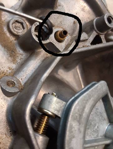

Finally got the tool. It is convenient, but takes some getting used to. Probably could have accomplished the same thing with a stubby screwdriver, but, oh well. Having a hard time finding the right balance with the Air/Fuel pilot screw. I started with 2-1/2w turns out with no assist from the throttle adjustment screw and cable adjustment.. Seems like it runs much smoother with the Air/Fuel pilot screw way out -- too far out - to the point where I think it's almost ready to fall out.
Is that normal?
Here are some pics. Sorry they are so large. Tried to scale them down, but I obviously don't know what I am doing.

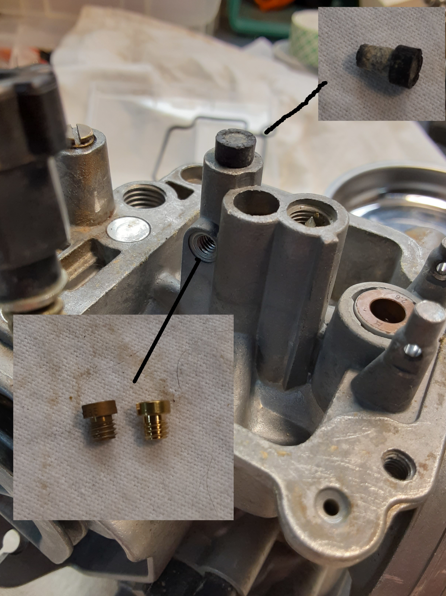

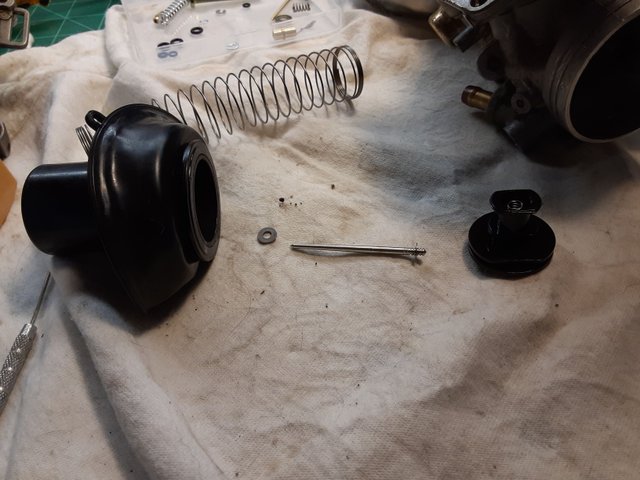

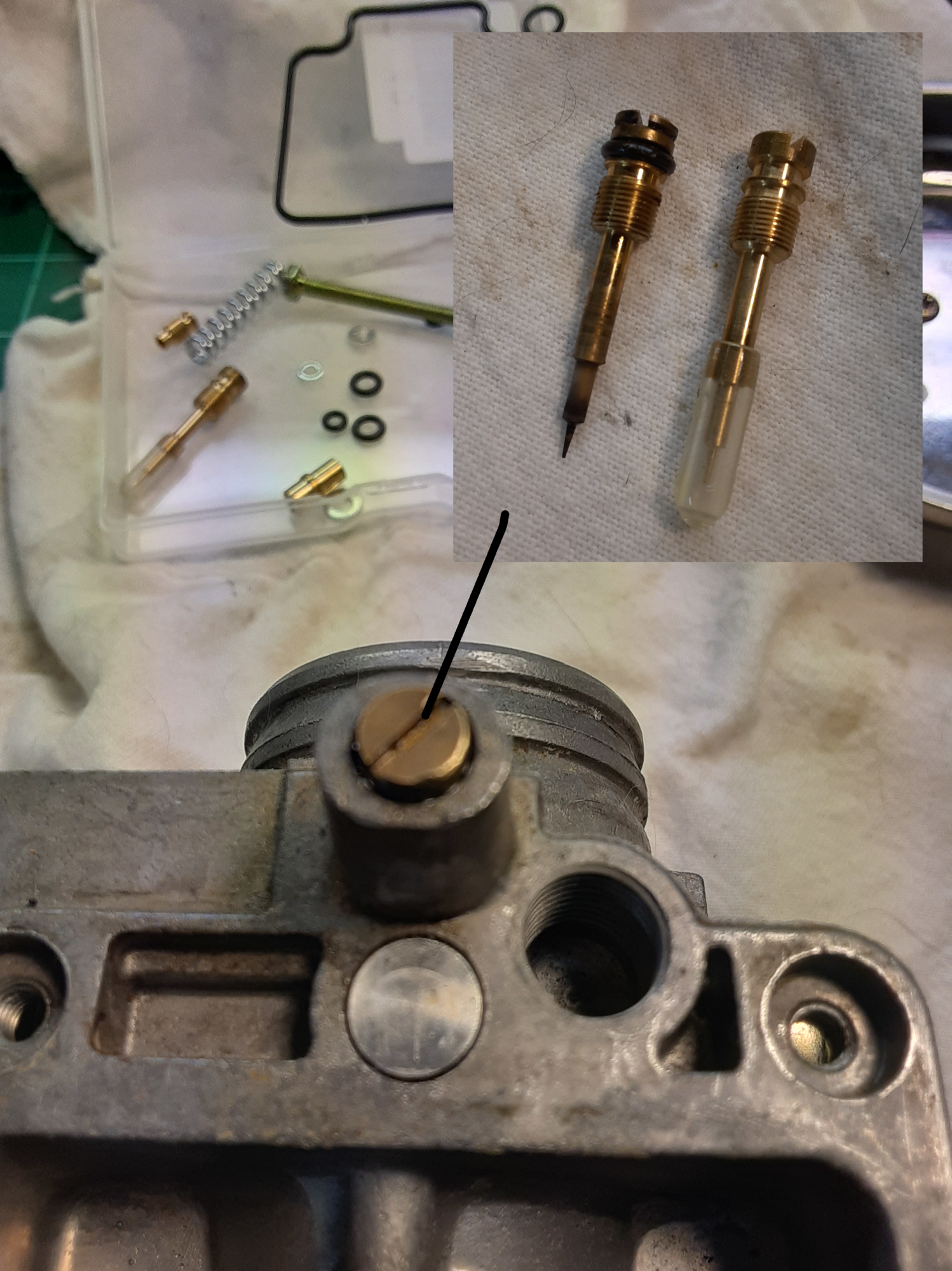

No pics of the main jet, did you change it? I never do, but then I never change any jets as a rule. I do change the main jet needle sometimes as this does wear, in fact I have had a few wear clean through and drop into the jet, blocking it, almost always Honda 500s for some reason. As I wrote above, this needle should be adjusted upwards if you think the bike is running lean. Makes far more difference than fiddling about with the idle jet screw. That jet bridge I can see in the box of bits can be put in the wrong way up, but I don't think it would run at all if you did that.

Yes I did replace the main jet. I just didn't want to bore everyone with even more :"fascinating" images of carb guts.
There are 4 or five notches on the end of the jet. I replaced the retaining clip into the center or third slot as recommended.
is this the "jet bridge?"
If so, then yes, I did put it in wrong, but as I was going back through the images I took, I caught the mistakes before reassembling.
I'll remove the main jet and move the retaining clip as you suggest and let you know how it turns out.

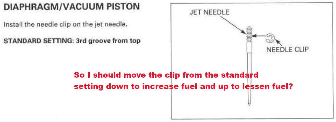

Please bear with me as I am learning as I go...Running lean means more air than fuel? By adjusting the jet "upwards", I think that means moving the retaining clip towards the pointy-end, so that it protrudes less into the cavity, allowing more fuel and less air? Or is it just the opposite?
Right now I have the clip positioned at the fourth notch from the top of the jet - closer to the pointy end.
And again, with the choke pulled out, it runs pretty darn good. After initial warm-up. releasing the choke, it idles pretty nicely. However, when applying throttle, it spits back or coughs like it's getting too much of something - fuel or air. My guess would be fuel, but I've already proven I don't know sh*t.

If you push the throttle open quickly they all spit back. If you open steadily it shouldn't, and this is usually a sign of a weak mixture, as any engine needs a rich mixture during acceleration, hence accelerator jets on old cars. Try the bike as it is, unless it is really bad when accelerating and, once it has done a long ride, shut off right away, no letting it idle then, once cool, remove the plug and take a look at the colour of the nose. This will tell you how far out the carburation is, plenty of pics of how it should and shouldn't look on the net. Did you check that diaphragm for holes? This is quite a common fault and very expensive to replace.
As for that jet bridge, I'm not sure I got the terminology right but here it is, fits on top of the emulsion tube, that main jet needle sits inside it.

Ummm....ok. Ya know...I didn't even know there was a jet bridge till you mentioned it and pointed it out.
It kinda hides up in the carb cavity.So, needless to say I did not even know it was there -- until you mentioned it. Thanks.
I did my research. Pulled the carb today (getting really good at it)(. And dug into it. Found it covered in goo. Replaced it. Cleaned out the goo. And ....
Runs like it used to run. Absolutely no issues.
