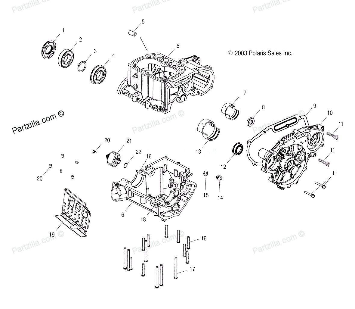

I new to this site, hopefully I'm in the correct area. I just rebuilt my engine started up fine I also installed the upgraded ignition system from Polaris. Machine runs really good. All of a sudden the engine is leaking oil out of the weep hole near the water pump. Looks like it might of sprayed oil out of the dip stick. I't seems to me like it might have to much oil pressure. I did install a new oil pressure dowel as well. Any help would be greatly appreciated. I'm really frustrated, spent a lot of money to get to this point and have this happen.
Old Aug 15, 2017 | 03:58 PM
Oil seal behind the water pump seal(#8) and if worn out it can leak engine oil out of the weep hole same as coolant can if the w/p seal is bad. Make sure on the dip stick that you have the small bolt attaching it to the engine case. A few lost the bolts and the dip stick housing can raise up and spew out oil. Not a bad idea to check that the pressure relive valve isn't stuck also. Plus welcome to the forums...

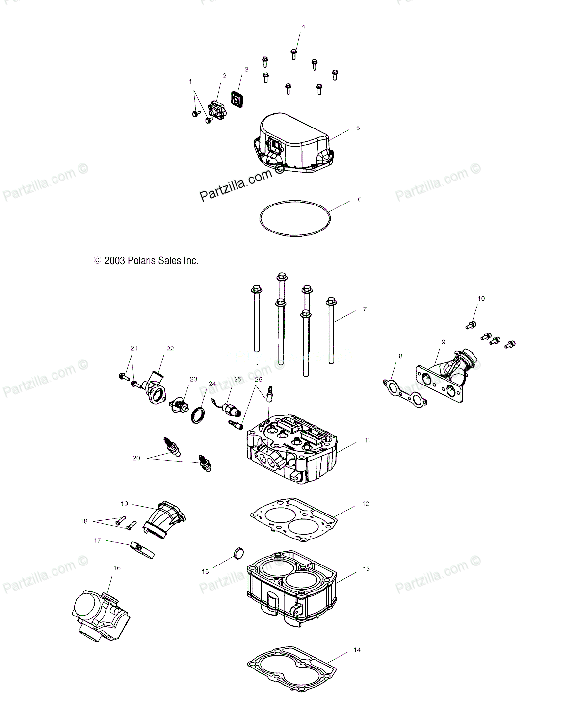

What would case this? To much pressure in crankcase. Vent tube not allowing pressure out? Is crankcase pressure and oil pressure 2 different things that happen inside an engine?
Old Aug 16, 2017 | 03:54 PM
Make sure you can feel air from the crank case vent tube going into the air box. If in doubt check that the reed valve isn't gunked up with oily residue. That could be the problem. If the crank case vent is open,then I'd still do an oil pressure check to see what it's showing.
