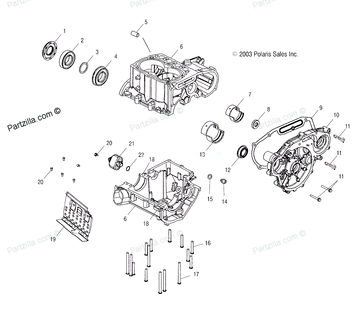

As best I can remember the small oil seal (8) closed end faces towards the outer case as shown in the parts break down.Open end is flush with the case.
