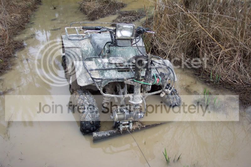

I somehow managed to get stuck while out with my camera. I don't recommend that! Not easy to get off the quad n not get wet while protecting the cam and also carrying a winch cable. [img]i/expressions/face-icon-small-shocked.gif[/img] But here you can see I added an old 18 volt drill to raise n lower the plow. And a better veiw of the mudflaps.

The plow when I first put it on. Also, the truck headlight and car fog lights (stock light stopped working and blew bulbs when they got wet, so they're junk).... and I like having a light that turns with the bars. And it shows the 23 inch tires in front.

Old Apr 17, 2008 | 12:43 PM
JustRandy's Avatar
Joined: Mar 2007
Posts: 5,227
Default bayou speed
Couldn't tell you how many times I've flipped over the bars because of that plow! I'm a little intimidated to ride very fast with the plow on. Even when fully up, the front shocks can still dive down and the plow can grab a root. The roots usually win! [img]i/expressions/face-icon-small-happy.gif[/img]
