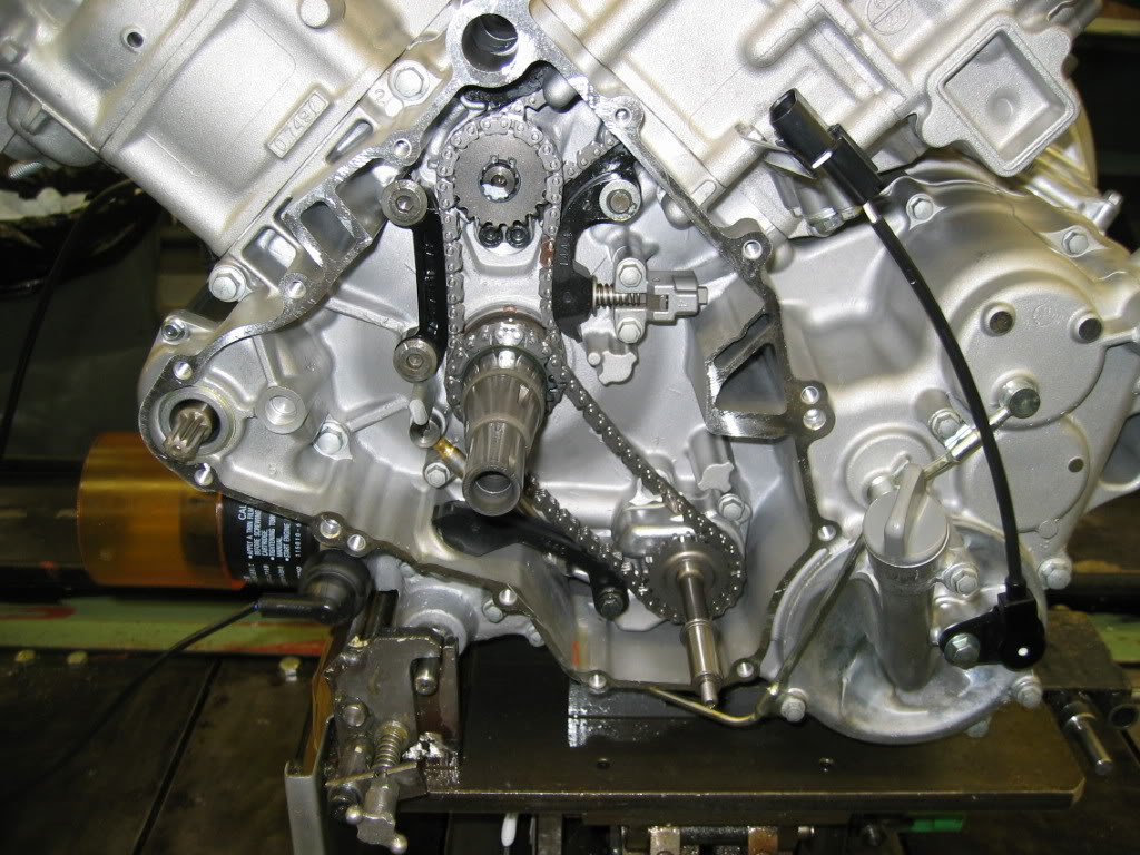

> Stretched cam chains, most likely the intermediate one. But it can be the top ones (one for each cylinder) also. Below photo shows the int. chain in the middle with the automatic tensioner which could be maxed out if the chain is badly worn out. One may ask, why does the noise go away after warming up. That could be simply because heat expands the metal and clearance gets tightened up.
Appreciate the help here man. As far as clearance, I've taken it wayyy below spec's and still there.....I only have about 3,000 miles, do you think the chainns or tensioners could be worn out?

As for the cam chain, it can wear out within 3000 or 300 miles depending how much dirt you sucked in.
