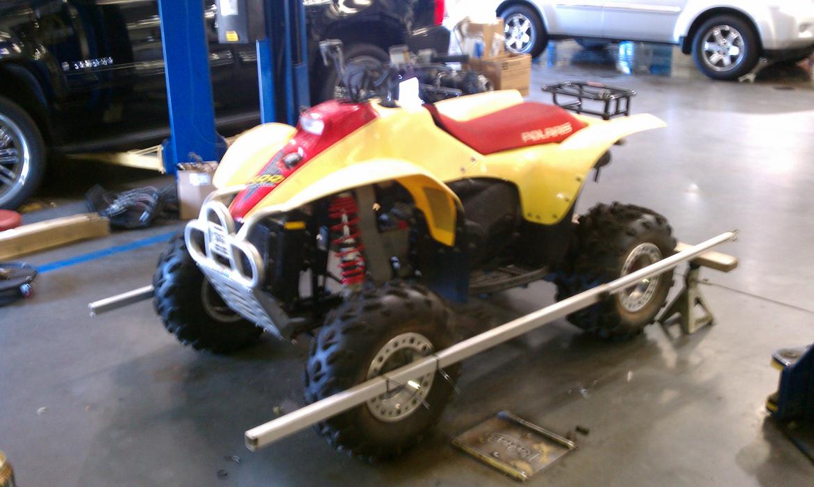

Hold the bars straight,get off and look at the front tires. Some manufacturers want them toed in a little, some like Polaris toed out a tad(1/8-1/4") See if you can check for your model and you can use the old string mode for checking or use an aluminum stud like we did in the shop. One person held the bars straight and tight,another tightened or loosen the tied rod shaft to align the front tire to the rear and allow for toe in or out.Plus the pic is one guys method of doing this.Plus on the tires look at the side wall as it usually shows recommended pressure or max pressure. On most of our full size machines we had 5 psi .

Only shows max psi. These are factory tires so I'm going by the manual. Will play with psi. I'm 230lbs so that could be considered a "heavy load".
Will check for toe in. Thanks.

I normally run 7 psi in the front and 5 in the rears. I've found if the fronts are too soft, they tend to roll under a bit in hard corners.Play around with the alignment, every bike handles a bit differently. I like to put someone of my size on the seat to check. Try some toe in, neutral and some toe out. See what suits your style of riding.
