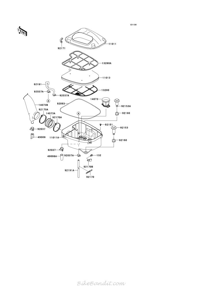

just bought a 2002 650 Kawasaki ATV Need to clean/replace the air filter. Not clear how the plastic retainers are removed so the metal frame and the foam can be seperated.
Thought I would ask before I break something
Old Nov 16, 2017 | 03:01 AM
Appears that the top plastic holder just snaps into the bottom holder.

thanks will try it today can not be too hard Just did not want to break anything on day 2

in caase anyone else is trying this the trick is to push the pins back through the holes ed
