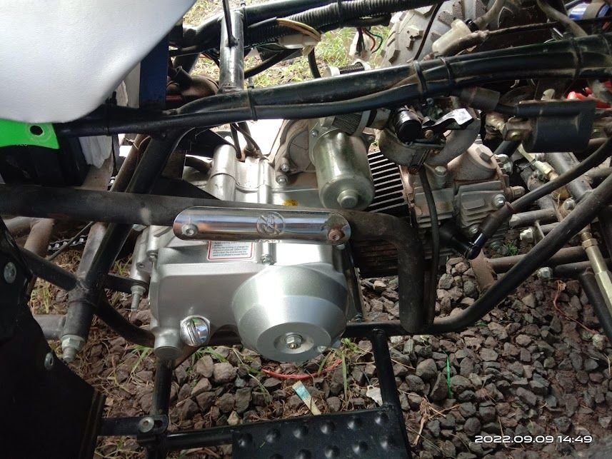

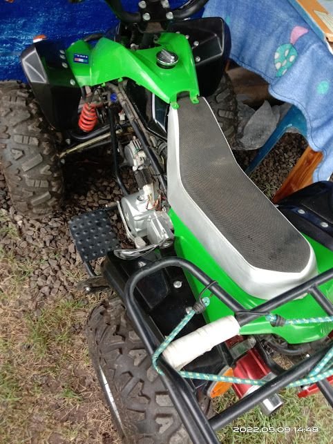

I purchased my son ATV online over 1 year ago can you please help what make is it, i need to purchase some parts for it as it won't start

That isn't really how buying parts for Chinese stuff works. I have no idea what it is. If there is a VIN number we may be able to pin down a maker. Tyres are an unusual pattern for a Child's quad, and the plastics seem to be held together with coach bolts? Again unusual, but the engine is the standard Honda Cub clone, made and used by many makers, so engine spares are generic. Electrical parts too are used by many different makers but wiring looms are for that particular machine, so I would avoid a "universal" loom unless the old one is burn't out. Let us know what parts you need, then we may be able to point you in the right direction.
