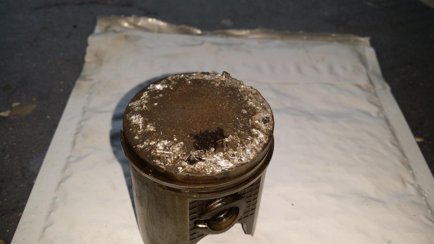

I haven't updated this in a while, so here are some new details. Got quad running decent. Took it out and my son loved it. After an hour, it started running dying out. I couldn't keep it running. No compression. Didn't even register on my gauge. I finally installed the Chinese cylinder and piston kit I bought, and it fired right up. However, after a few minutes it stalled. Started first crank, stalled again. Each time, it got harder for the starter to turn over. Actually blew a relay, so now I have to go grab something generic, and wire it in. Can't keep paying $28 for a relay. After I take the plug out, and run the starter a bit, I can plug it back in and it fires up. If I hit the gas, it'll stall, and then it won't turn over until I pull the plug, and go through that again.
I tried doing a compression test, it gets to 100psi, and then the starter can't turn the motor over any more. Any ideas? Thanks in advance! I uploaded a picture of the old piston. Looks absolutely destroyed.
