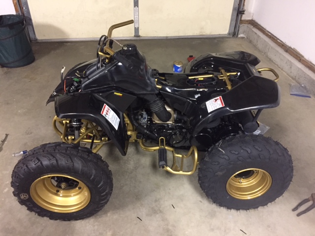

Here is my LT80...there is soooooo much more that can be done
That's a good looking machine. I like the front suspension mod.
