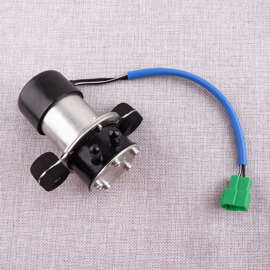

The current challenge - it's gone through THREE fuel pumps since last August. We order from the only parts supplier we can find - in China - wait months, and slap it on once it arrives. Turn the the key and the fuel pump vibrates... doesn't seem like it should be that noisy. The most recent one lasted perhaps an hour of total runtime.

Question: The logical brain of mine tells me I shouldn't waste time trying to find the "right" fuel pump... that any 12v pump with the same flow rate and power connector should work. Heck, I'll duct tape it to the frame if it doesn't match up to the mounting bracket. Tell me I'm not out to lunch... please!

Here's the crappy fuel pump:
(eBay source)

I pulled the plug, cleaned it off, and the darn thing started right up.
I am chagrined.
I think what's happening is the old fella just uses it to putt around the farm, and it never gets a good run at higher RPMs. The plug carbons up and that keeps it from starting.
What I don't understand is how slapping a new fuel pump on it achieved the same result the last two times.
D'oh is me. Will do the basics in the future -check the plug first - before going off screaming on the internet.
