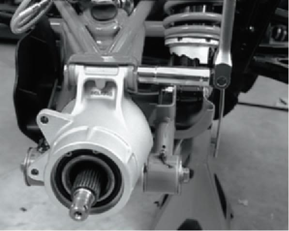

10. Remove upper control arm bolt as shown.
11. Remove both lower control arm bolts.
12. Remove bearing carrier.
REAR HUB INSTALLATION
1. Insert bearing carrier on drive shaft.
2. Align bottom of carrier housing and lower control
arm. Grease and slide lower control arm
bushings into place, securing corner housing.
Install upper and lower bolts
Lower Control Arm Bolt Torque:
40 ft. lbs. (54 Nm)
Upper Control Arm Bolt Torque:
35 ft. lbs. (48 Nm)
3. Install and torque both lower control arm bolts.
4. Lift bearing carrier until top aligns with upper
control arm. Install and torque upper control arm
bolt and torque to specification.
