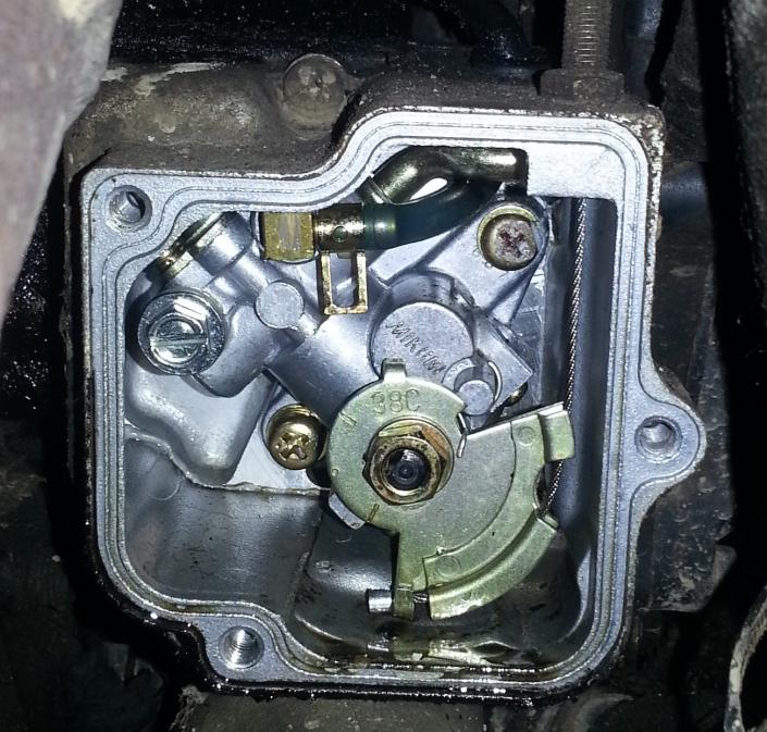

If you have the oil pump adjuster close to what the old one was,then you shouldn't have any problems. This pic of a pump shows to be a little on the rich side,but won't hurt. Same if you're a tad lean. The slash mark you can see,the other mark is faint on the post.

On that picture I can see the threads of the bolt that goes into the oil pump....on mine i have the nut all the way down.

Have at least 5/8" adjuster threads showing on the pump or it could be a little too lean.Almost all I encountered were set around this a or a little more from the factory. Any cable lube is fine,the problem is getting it to thoroughly lube the cable.We used this on motorcycles,best thing around.Motion Pro Cable Luber - Street Motorcycle - Motorcycle Superstore
