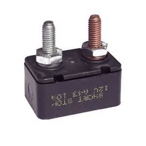

There's a sealed 10 amp circuit breaker for the fan under the front panel also. It can be corroded and not allow the fan to operate.You can get these at any auto store also. Just slice the pouch open if it doesn't have power to each side of the red wire. Plus a manual would be the best help.Here's a pdf service manual if you don't have one.http://gh-ftp.com/ORV%20Manuals/Pola...0%20-%20SM.pdf
