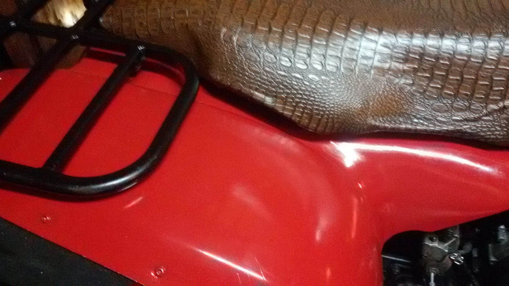

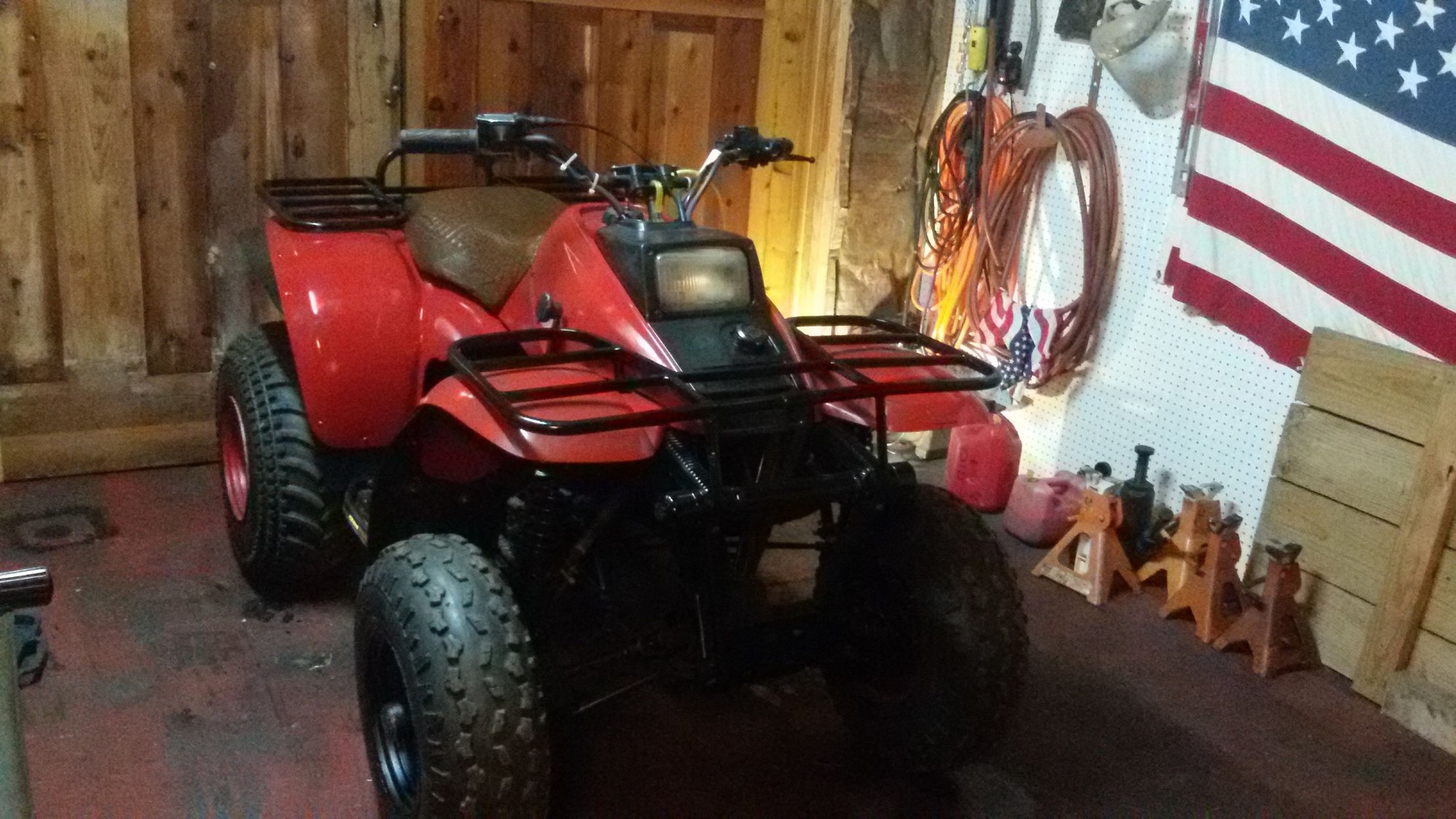

The rebuild is complete, overhauled he motor, flushed the transmission, rewired a few lights, bondoed/painted and resecured plastics!
