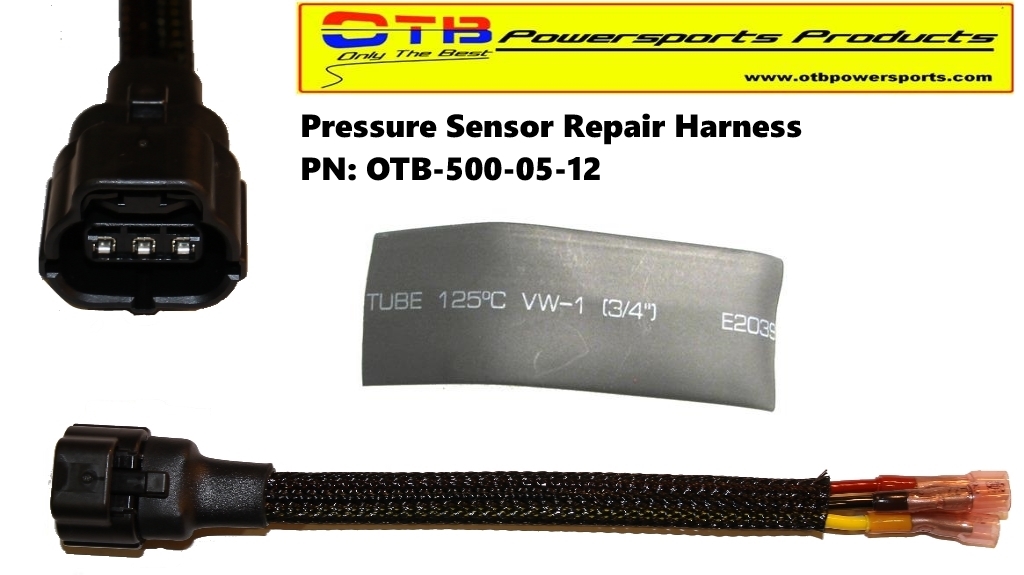

I'd either look on ebay for a throttle assy if it's rusted or even here. Little over 100 bucks for a new one complete with etc switch and awd. Dirt Cheap Yamaha, Polaris, Suzuki & Kawasaki OEM Parts & Accessories – Cycle Parts Warehouse Some codes throw are bogus,but most times when code 45 is thrown it's a problem on the tbap wiring harness or connector. Read the "sticky" post above this section on efi problems. Links to a place that has better aftermarket harness repair kits than the oem crappy ones I had to install that kept failing. Only The Best
I was looking at those yesterday but was worried maybe I have some other problems. An entire wiring harness is cheapish, might that be a better route? Or is there any way to pull the pins from the stock connector and replace the wires myself? My plan was to pull the entire harness today and do a continuity test on every wire but its -22 today and I've never pulled a harness from one of these quads before

You can check pins and wires if you wish,plus look for any bare wires or soft feeling wires that may have melted internally. The complete harness comes with the SAME thin crappy connectors and thin wiring to the sensors! That's why I mentioned the other site. Only The Best I replaced more oem Polaris harness repair kits than I ever want to think about.. Multiple times on the same vehicles also when the first kits I installed failed again. That's what the "sticky" post section above on efi problems is all about. The thin wiring and crappy connectors.
I've read a lot about the crappy connectors but when I checked yesterday everything seemed good. But I've read that it breaks under the insulation. I think I'll buy the 3 pack of connectors I just feel its a little steep (I'm from Canada so each connector comes to around 90 dollars and 200 for the 3 pack) but hey if I can have this thing running smooth for 200 bucks that's 800 dollars all out for a running 500

You're looking at the wrong thing! Not necessary to buy all three! Just the pressure sensor repair kit that triggers code code 45! That's the main one that fails.. This one for 39.95.
