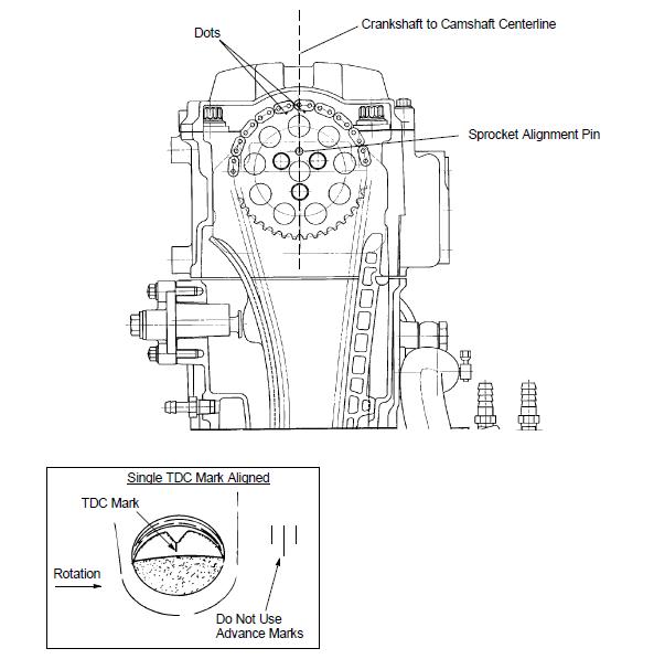

Can you use a regular automotive timing light?
Old Jun 15, 2016 | 02:09 PM
  #19
You'd also need an accurate rpm meter to check timing with an automotive timing light. It can be used to see if an ignition is possibly breaking down. Many old techs have done this. If the light stays constant at high rpms,then ignition wouldn't likely be the problem. If the light pulses in time with any engine miss,then that's a sign that possibly you have a break down. The manual shows you the basics on how timing is set and whether it's off or not mechanical wise. You'll have detailed pics and instructions like this one the Sportsman 500. Just get the manual for your machine and you'll be surprised what all it can help you with.
Attached Thumbnails polaris sportsman 335 bad throttle bog-2011-05-21_125845_00_polaris_500_cam_timing.jpg
