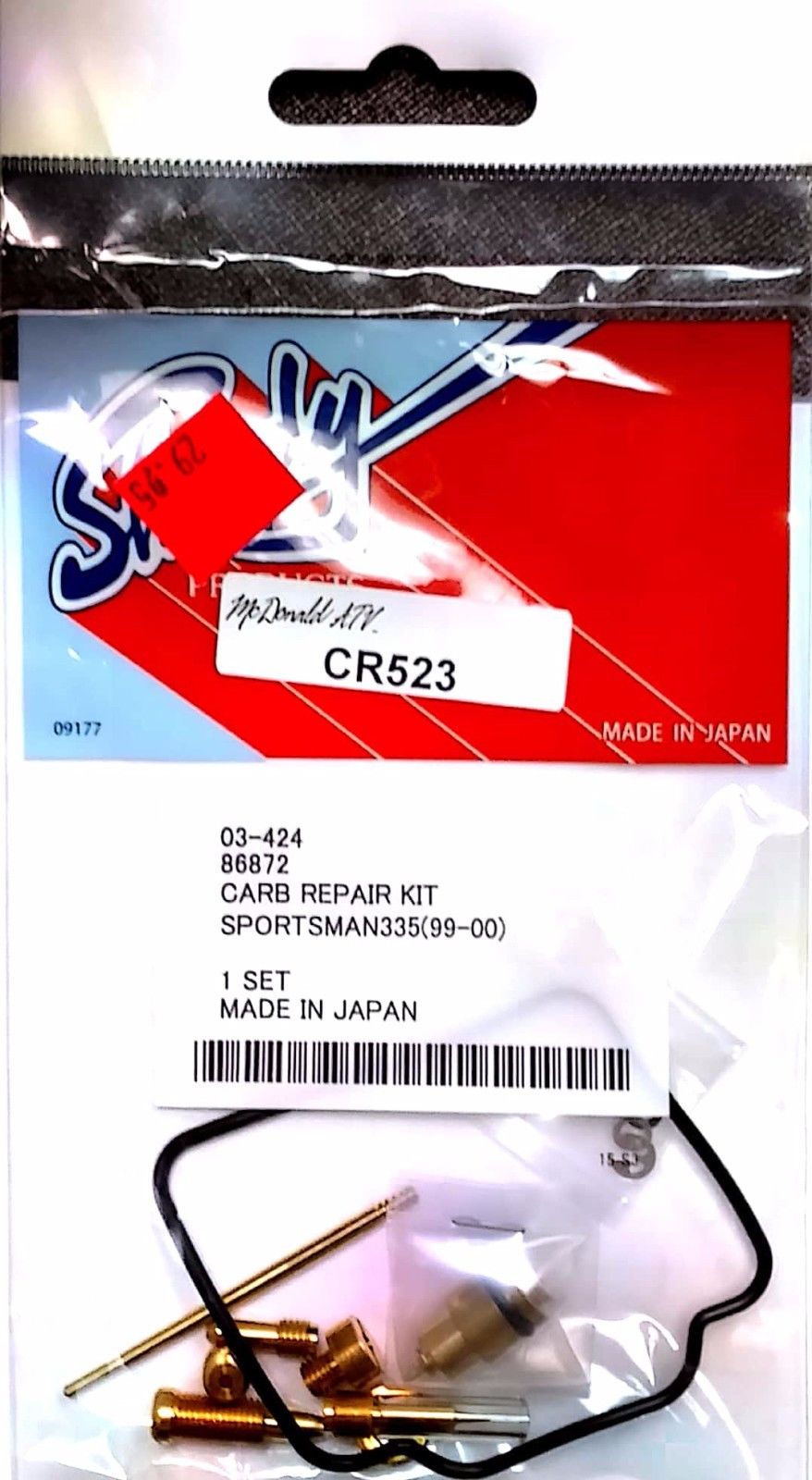

Aftermarket carb can be the weak point as many are hit or miss. Some may have machining bits in the bowls along with trash. Some people have noted that some orifices weren't drilled all the way through. Unless the oem Mikuni is trash,better to rebuild them with a good Shindy carb kit. If the carb is eliminated,then check the flywheel key next. Easy to see if it's split and if the flywheel has moved when you remove the nut. Same thing for the crank sprocket key. If split it can throw cam timing off. Don't know if I mentioned it,but most Polaris atvs won't run right unless the air box and filter are installed also.
