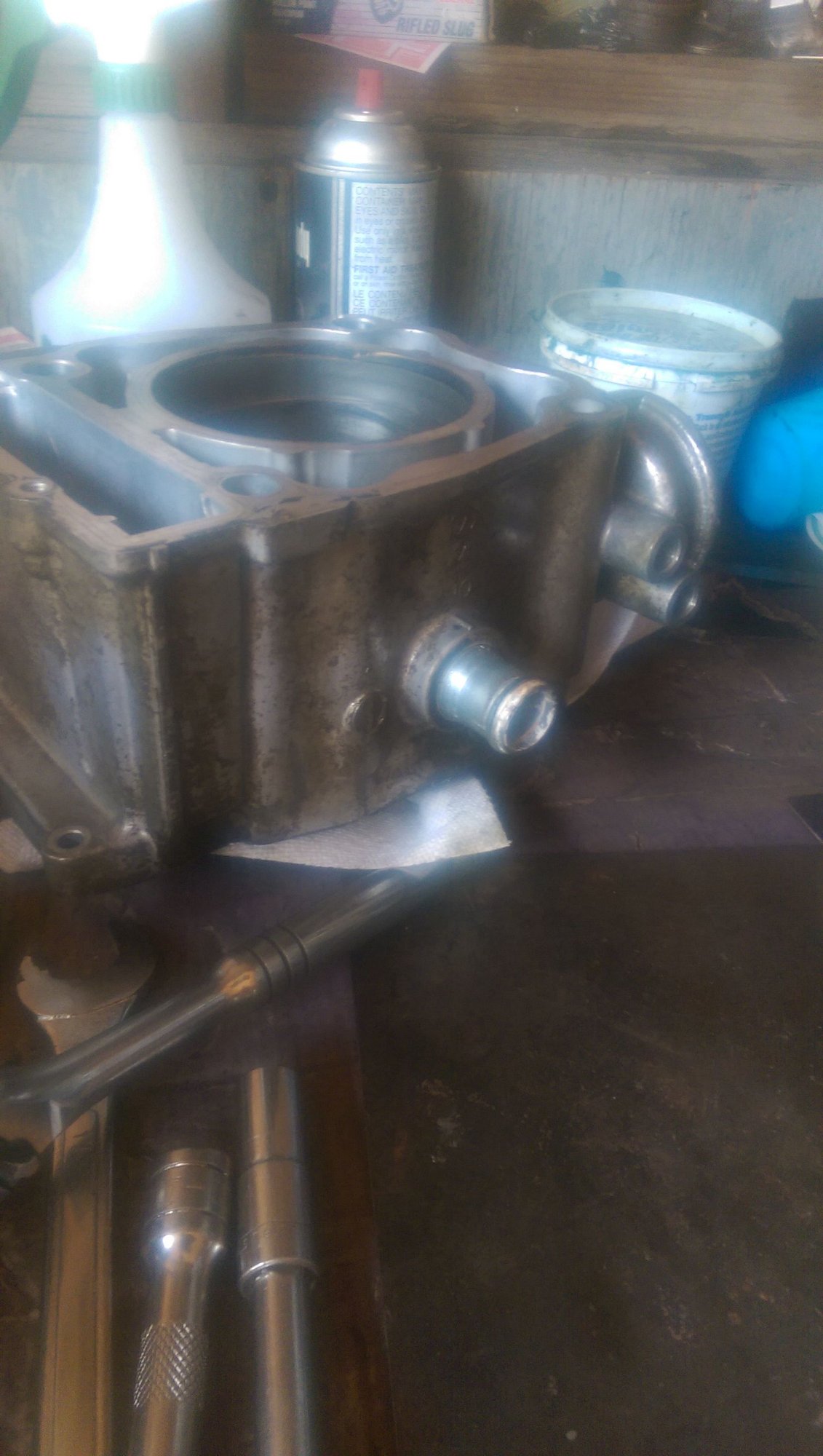

All is back together and no more noise from the valves. The engine is almost ready for install. One last obstacle is the aftermarket cylinder does not have a coolant flange. How do I remove the factory one from the old cylinder? It looks press fit

I butchered the old cylinder with my sawsall by cutting on each side of the flange the length of the cylinder removing the cut out portion then into my vise and then cutting to the flange at three spots. A light tap with a chisel liberated the flange from the cut out piec. Saved 60$ not buying a new one.

Guess you meant $33.60 as that's the cheapest I've found on the flange. Put the flange in the freezer and heat the cylinder up. Use some red loctite andd tap the flange in. What was the cause of the valve noise or did it just stop?
