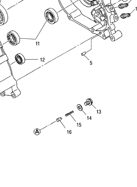

Located at the front of the engine. Hex nut. The bullet can get stick and cause oil tanks to leak back into the engine sump. Don't know if that's your problem,but if it's a whitish smoke,can't smell any burning coolant,the coolant pressure test shows ok,then if the relief valve isn't the problem,then when you sunk it is must have sucked in some dirty water.May not have shown up when you drained the oil,but possibly enough to cause oil blow by on the rings. Relief valves can also cause some problem on other engines such as the 800.

Your is items 13-16 in the attached pic.
