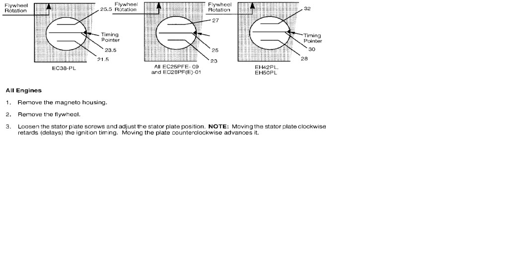

So opt question clockwise rotation of the stator will advance timing and counter clock to retard?
Old Aug 24, 2016 | 03:03 PM
  #17
Clockwise retards timing,counter clockwise on the plate advances timing.
