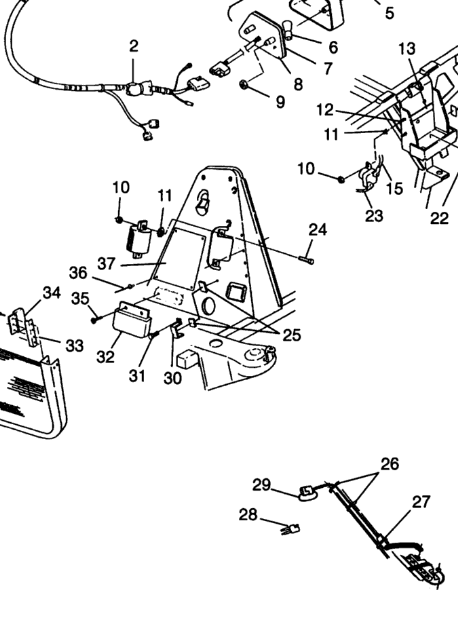

Did you ever pull the black wire from the reverse limiter module? If not they can fail and at times limit in forward.Plus pull the fuel line from the carb and crank the engine over. Should be a steady stream of fuel if the pump is ok.

Where is the rev limiter module located?
Old Oct 2, 2016 | 05:01 PM
  #45
Module right below the terminal board. Has about 4 wires if I remember. Just pull the black wire. That defeats this module and also allows full power in reverse without having to push the over ride button. I've had plenty of them fail and limit in forward range that can mimic a carb problem. Item #32 in the break down.

That definitely made it better for sure was able to get full throttle and found another issue. Hole in the exhaust manifold fortunately I have a spare just have to install it and haven't been able to adjust the cam so that needs to be done as well but seems better do I need to replace that reverse limiter module probably will just gotta figure out where any insight?
Old Oct 2, 2016 | 07:23 PM
  #48
Don't spend the $ on a reverse limiter module... They all fail. You won't need to push the over ride in reverse to have full power but to engage awd you will will still have to. Thought I mentioned earlier on this module and what they can do,but guess I forgot..

Sorry about forgetting about that crappy limiter module that can limit rpms, but on the bright side you don't have to worry about a cam problem now either..
