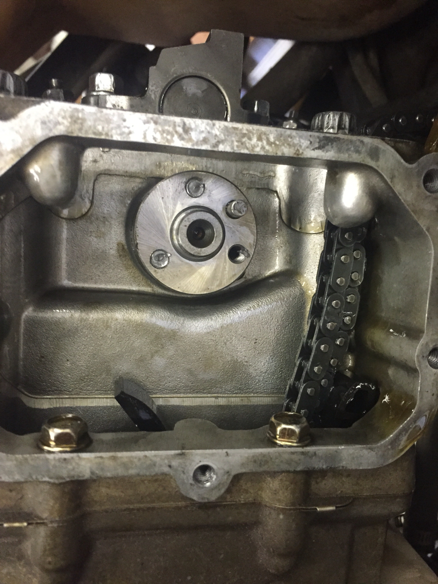

Well this sucks OPT Attachment 11369 apparently old camshaft bolts failed one backed out cleanly one sheared off ons one backed out 3/4 then sheared off ughh

You have jb weld on the threads or something.. I've seen some bolts back out that people didn't use loctite on but not any that would break off..

Dang it sucks can't believe that happened

Not sure what to do from here I guess a new cam maybe try an ease out and back the bolts out but one of them is in the bottom end somewhere 😱

Thin flexible magnet may get the bolt out without having to tear things apart plus try an ez out. Worst case is a new cam if things get buggered up. https://www.google.com/aclk?sa=L&ai=...HfEUCCMQqCsIDA

Yah I'm most worried about the bolt I can probably back the broken studs out with an ease out ughhh just annoying I hope that bolt sneaks out. What is at the bottom of the slot the timing chain ?

See if this helps..https://atvconnection.com/forums/pol...ml#post3305250

Perfect I forgot about the stator plate so no real place for it to go lol

You may have to pull the stator plate anyway if you have to replace the cam unless you can hold the "T" mark on the flywheel steady when you go to replace the cam chain.
