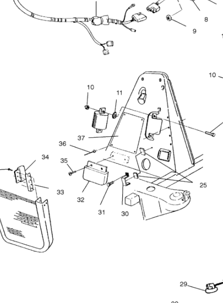

Pull the black wire from the terminal board that goes to the reverse limiter module.Modules can short out and limit in forward range also. See if this solves it. Item #32 is the module.

I'll unplug it tomorrow and see what happens. What does reverse limiter do exactly and how does it affect forward or in nuetrAl.it does it refine in neutral too

Reverse limiter was a needless safety device that only allowed full power in reverse when you held in the over ride button on the left control switch. They all fail eventually. Sometimes when they do machines will die when shifting from neutral to reverse. Some times you can hold the over ride button down first before shifting and it will run in reverse.Once back in neutral or forward range you can let go of the button. Other cases the limiter will affect forward range and not allow full power. Whether this is the problem or not,leave the black limiter wire unplugged. You now can have full power in reverse without having to push the over ride button.Don't know of any other atv that has this,but it's not needed.
