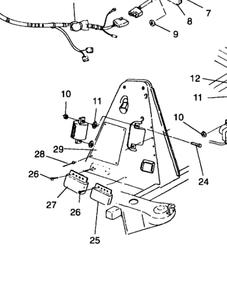

Hopefully with more running the smoking will go down. One other thing to try,if I haven't mentioned it already, is to pull the black wire at the terminal board that goes to the reverse limiter module as when they fail(all of them do) they can limit in forward range also.Might help.Item #27 on the parts break down is the location of the limiter. Doing this has brought some of these old machines back to life.
Last time I ran this in a ride, reverse limititer, and override were still functioning normally, and it still went bloody fast (for me, 45 MPH+). Have not touched the pixie board, should be fine. Will check when getting home.
