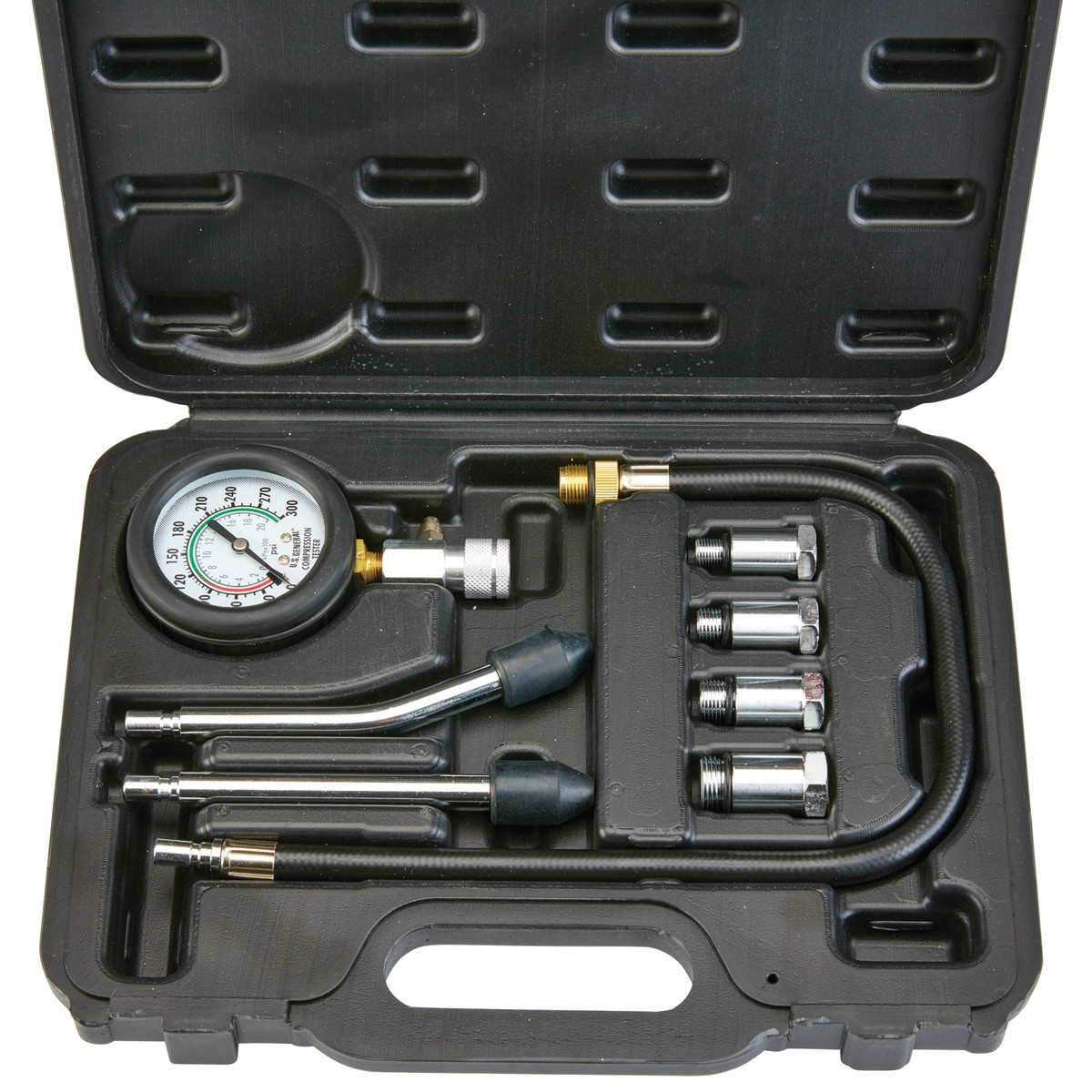

Just get a new compression tester.This one is similar to the Snap on kit I have.Auto Engine Compression Pressure Tester Kit w/ Extend Hose M10 M12 M14 Adapters | eBay Or a cheaper one from Harbor Freight for 25 bucks.
Oh god, Horror Fright! I jest. Anyway, I already have one on the way, a better one. It probably looks similar, but I bet if you took them apart, they would be quite a bit different :P.

Harbor Freight and Northern tools aren't Snap on or Mac quality,but good enough for the average home mechanic.Most people don't want to shell out 240 bucks or more for a good kit like the one I have for a one time use.https://store.snapon.com/Compression...e-P650745.aspx
Nah, I just got one with a massive set of adapters. And a point in the line that rotates, unlike the ones I now USED to have. It already vanished on me. I left it on my bench, was gonna dismantle it for laughs this morning. Stuff came up, then I get out there at 3, the thing was gone, and nobody else had been in there in the meantime. Darn thing is possessed. Now I REALLY wanna find it and dismantle it! :P
Wasn't but $30, but I need the spare adaptors, my I-forgot-where-that-goes drawer is getting unusually empty. Gotta have something to put in there, otherwise the drawer below it will slide open and not stay shut, the box is not level, and I have nowhere to put all the darn wrenches, ratchets, sockets, and the like while I try to level it, just too much in there. What's 5 bucks more when it is gonna save me a trip to the hospital from tripping over the darn thing!
