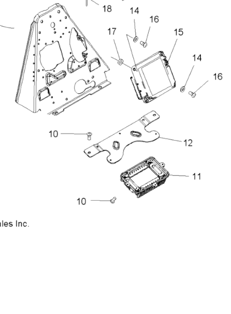

15 volts back to the battery? If so that is a little high if your meter is correct. That usually involves the high dollar command module. Item #11. Before you throw parts at it get this cheap manual and go through the electrical charging checks.2007 Polaris Sportsman 500 EFI Service Manual PDF Download
