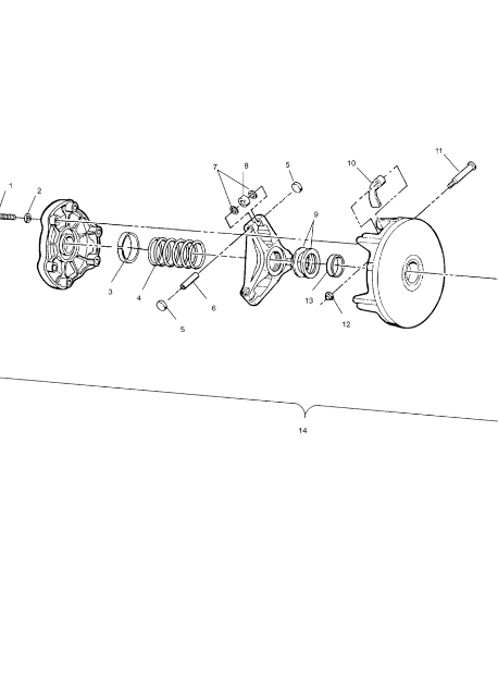

Drive clutch guide buttons worn down to where the spider is clacking against the clutch towers.Usually quietens as you give it throttle. If in doubt just pull the drive clutch and crank it up. There will be a little in and out play on the drive clutch.Another way to tell is to rock the clutch outer cover plate side to side. Any amount of slack is magnified when you crank it up.Items 3,5,13. Be sure to see if the guide button towers are heavily grooved where the buttons slide.

I did look at clutch I cannot show it in about an inch also does move side to side slightly. I grabbed a weight and it wiggles all over the place. So a clutch can sound like the motor is knocking? I'll pull it. If not it what could it be. Some say it's normal sound?
Old Jan 26, 2017 | 08:45 AM
Originally Posted by Ironmike340
"also does move side to side slightly." I grabbed a weight and it wiggles all over the place. So a clutch can sound like the motor is knocking? I'll pull it. If not it what could it be. Some say it's normal sound?
Not really normal but happens when parts are worn. A new clutch is fairly quiet. Weights usually aren't the problem,just guide button and clutch bushing wear.Complete rebuild kits are available.http://www.ebay.com/itm/EPI-Primary-...RYT1fs&vxp=mtr If the towers are really grooved,buttons worn down to nothing,then might be cheaper to look at a new clutch. Niche looks to have one of the better built ones out there. http://www.ebay.com/itm/Polaris-Spor...5XiPr6&vxp=mtr Read about it's description at the bottom of the page.
