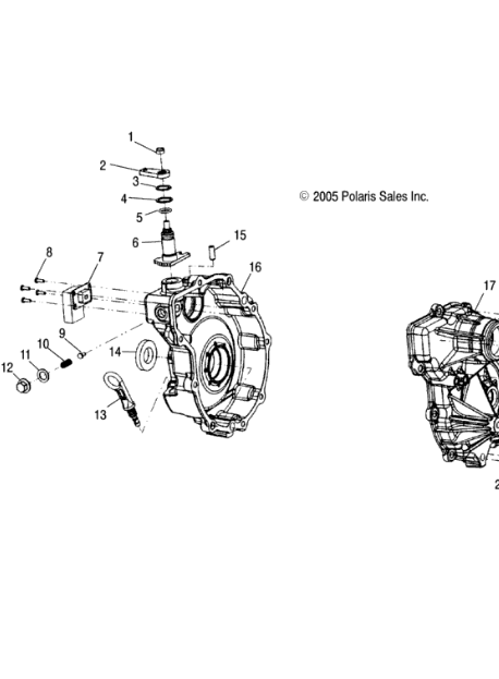

have another ? on that same atv the reverse light does not come on when in reverse how to fix it and what bulb to get
Old Feb 9, 2017 | 08:41 AM
  #18
Check the wiring to the indicator. Wiring diagram in the manual can help also. If one section/bulb is burnt out, the whole thing has to be replaced. Not cheap.4010459 - PANEL-INDICATOR SVC STD PVT | eBay Looks like these tiny indicator bulbs are similar to the awd bulbs in earlier model. Also hard to find.Also check the wiring from the gear position switch on the gear case.May be as simple as a bad connection or a wire shorting to ground. If no positions are shown on the indicator or just one,the switch itself may be bad. Again this is where the manual comes into play.Item#7 on the gear position switch.
