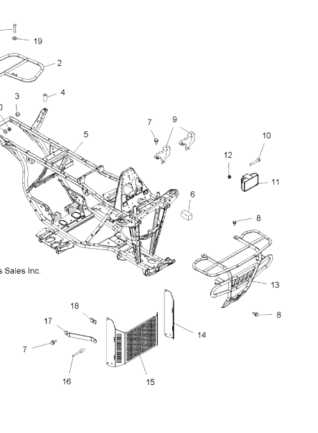

how to get the top end with the clutch kit and what's a good oil to use and spark plug and how to take off the front rack completely off but still have lights thanx guys
Old Feb 4, 2017 | 08:30 PM
Rotella T6 5w40 is a good cheap oil to use.Use the stock Ngk Bkr6es plug. Don't under stand why the rack removal just for relocating lights as the rack also offers mounting for the oil cooler screen along with some protection for the oil cooler itself.
