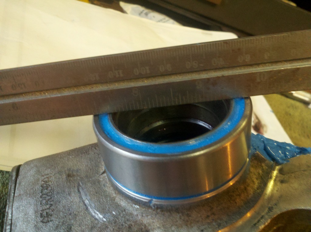

Check coil resistance on each strut. Should be around 24 ohms on the gray and brown wires.If this checks out make sure the strut coil sleeve and inner strut pole are even with each other and not ground down.Armature plates are also a weak link and cheap to replace. Hub nuts should be torqued to 12 foot pounds.Too tight or too loose and the mechanical function of the hubs won't work correctly even if the hub coils have power and ground wires are ok. The best fluid to use is still the Polaris Demand Drive Plus.

Ohm meter just checks the coil resistance to see if it getting too weak to hold the armature plate tight enough while in awd mode. The plates themselves can warp over time and wear. 10 bucks each on the plates if they need to be replaced. See if this guys pics helps on the strut.AWD Hubstrut Hilliard Clutch Troubleshooting/Diagnoses - Polaris ATV Forum
