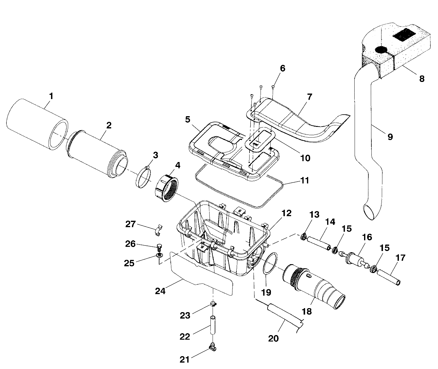

Another question for you. Is there another air box that will fit this model with modifications?
I'm having a hard time finding an air box for the 96-98 Sportsman 500 as I'm looking for used parts to keep my cost low.
Old May 12, 2017 | 02:04 PM
I hated the early wing nut air box lids as the studs would always crack off. 99 models went to the better clamp style air boxes. You might keep a check on these on ebay.1999 through 2005 or 2006 has the basic same box. You might have to change the carb to box tube also,but not sure.

Thanks - I'll do a little digging. I just wasn't sure if a 99 box would fit on the 98 but I would think with modification it would. I'll order one and try it out. If all else fails I'll just sell it on ebay if it doesn't fit.
