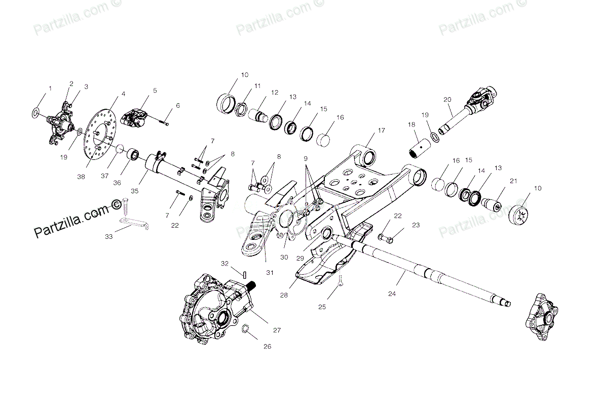

Sorry I couldn't figure out how to start new forum so I hope you can help on this one .. I just bought a 01 polaris magnum 325 4x4 and it is giving me real trouble popping in low gear and when I do it's extremely hard to get out .. it grinds when riding and I am stuck on what it might be ? Any help ? Oh And I can't for the life of me find the transmission dipstick or where to fill it with fluid
Old Aug 20, 2017 | 04:27 PM
  #16
My first guess because I had to do a few of them is the coupler on the rear prop shaft has stripped out. There's a grease fitting on it but most people didn't know it had a coupler let alone a grease fitting.Plus it was hard to see the zerk fitting through the hole in the box frame to be able to grease it. Part#18.If you have help you can pull the swing arm assembly. If it's just you then easier to remove the rear diff,drive shaft and tubes.If that's not where the problem is the could be a silent chain or gear problem in the gear case.This gear case is complicated.Drain plug on the side or bottom and 9/16" fill plug. Have to look over the foot well to see the plug. On any of this you need a good manual.http://polaris-atv.brssm.com/2001-Po...ce-Manual.html

My first guess because I had to do a few of them is the coupler on the rear prop shaft has stripped out. There's a grease fitting on it but most people didn't know it had a coupler let alone a grease fitting.Plus it was hard to see the zerk fitting through the hole in the box frame to be able to grease it. Part#18.If you have help you can pull the swing arm assembly. If it's just you then easier to remove the rear diff,drive shaft and tubes.If that's not where the problem is the could be a silent chain or gear problem in the gear case.This gear case is complicated.Drain plug on the side or bottom and 9/16" fill plug. Have to look over the foot well to see the plug. On any of this you need a good manual.2001 Polaris Magnum 325 4X4 Service Manual PDF Download
