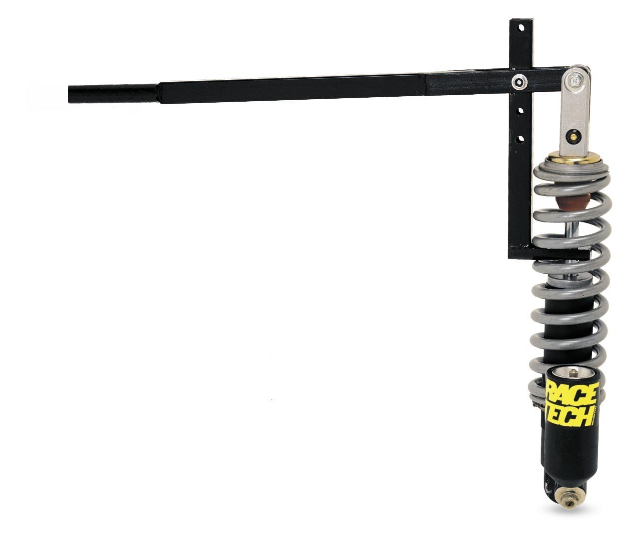

Old Jul 20, 2017 | 05:09 AM
Most cycle/atv shops can change this out in a couple minutes if they have this good spring compressor. It saved me a lot of time and frustration.
