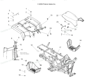

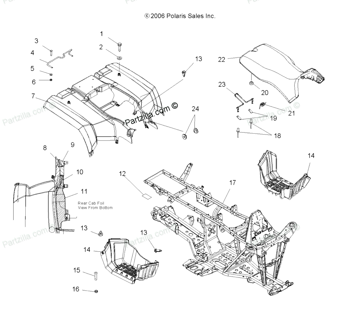

In fixing that I found that where the strut mounts to that cross member it is badly damnagaed. Do you know where I can find that cross member part number so I can order a new one?
Old Dec 25, 2017 | 06:02 PM
  #43
If you're talking about the front strut mount section,it's part of the frame itself. Can't get it separately.
Attached Thumbnails 4 wheel drive-77fab8e43fe60600bce3ed1f9c1a2eba23dc774e.png
