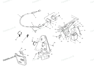

If it load tested ok,check what the battery is showing at an idle or slightly above. Should be charging close to 14 volts if the regulator is working ok. Regulator is at the front of the machine close to the radiator. Item #29 on the parts break down. Also check for any regulator wires that may have pulled out of their connectors. Common problem on some year models. If it turns out you need a regulator,plenty of them on ebay and amazon.https://www.ebay.com/itm/Rectifier-R...pTmdAL&vxp=mtr
