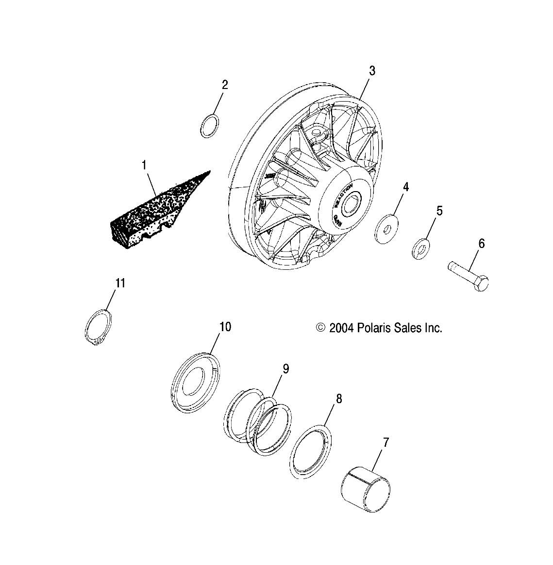

So I decided to pull off the clutch cover and see if the primary was still grabbing, which it was. I pulled the primary off to see if it needed cleaning or anything and the two bushings that are supposed to be teflon were wore completely to brass..so those are going to need to be replaced...which got me thinking more about your last message...
Can you tell me which parts you were specifically talking about when you say "bushings, guide buttons, ramp, or rollers"? I've never rebuilt a clutch like this before so I'm not sure what should all be replaced...

#1 and 4 on the drive clutch along with 6 guide buttons#10. Rear clutch has a bushing also,but doesn't show the rest of the parts inside. If the bushings are worn down to the brass they need to be replaced.This could be a big part of your problem along with the different belt. This is something I'd let a dealer do as the they have the tools to drive out and pull in new bushings. You could damage them at home.Plus they can replace any other worn parts needed in both clutches.
