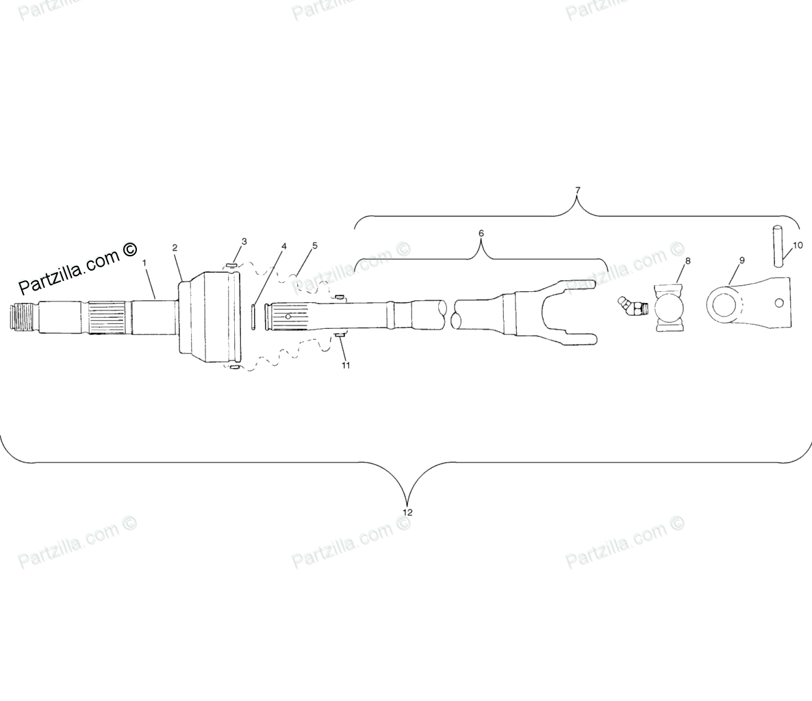

Now that I'm to this point the pickup coil is where I'll go thank you sir for your help. Now to shake down the rest of the machine if the owner will get me the fuel tank lol. How problematic are the front hubs. This ones missing both front cv shafts from the cv to the front diff ujoint for some reason
Old Jan 25, 2018 | 08:47 AM
  #15
Fuel tank and drive shafts missing...PO more than likely had problems or simply destroyed the drive shafts and used it a a 2 wheel drive. You need the manual I listed for hub service as there is a lot to check and parts that may need replacing. You have a project on your hands.. Here's a video on hub service.
