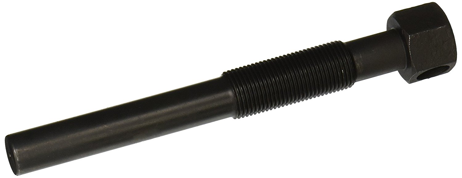

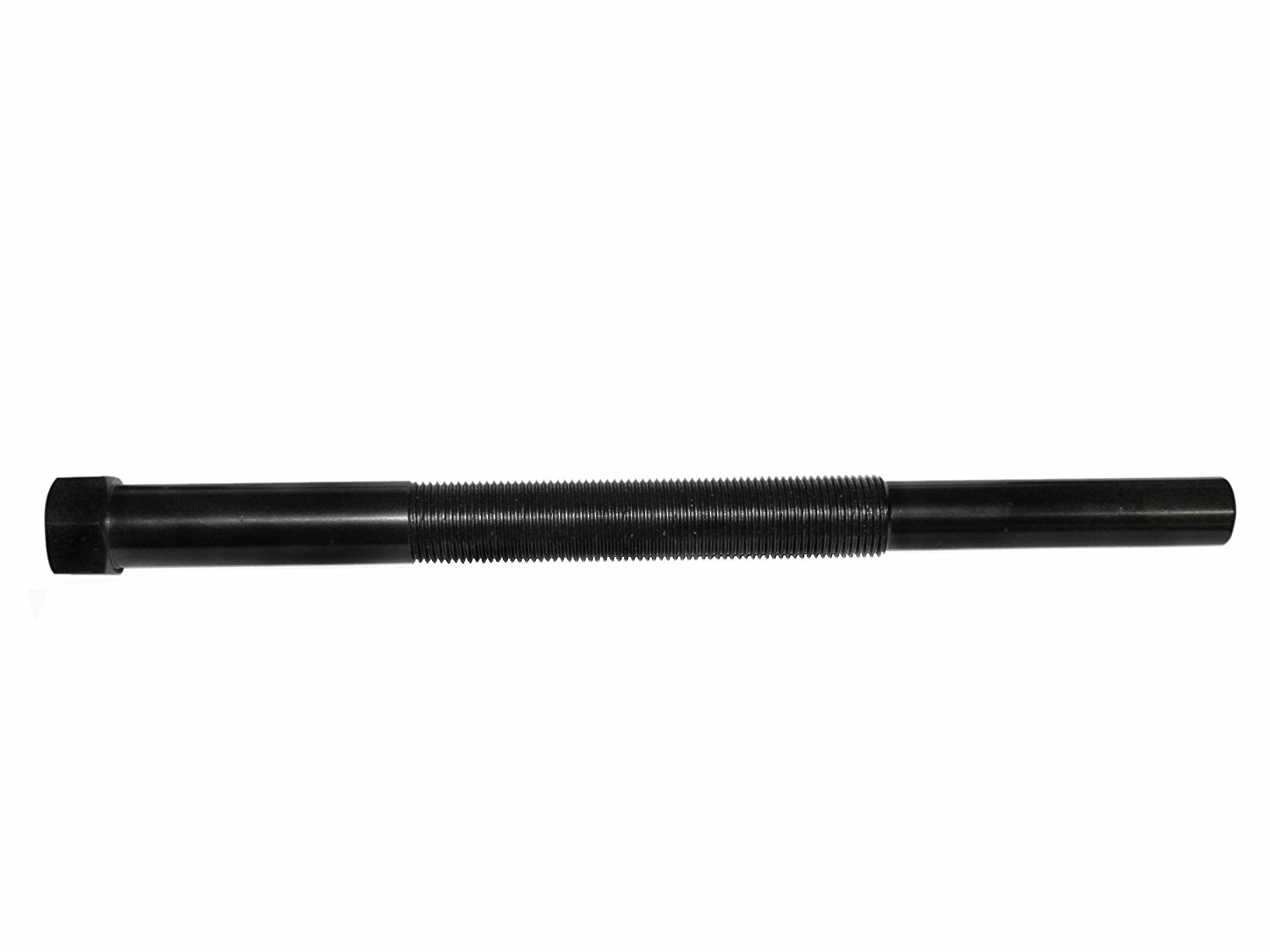

Hey guys, anybody know it the regular old clutch removal tool works on the new XP clutches? Or do they have a different thread?
Old Mar 29, 2018 | 05:57 AM
Doesn't appear that you can. Takes a PA-4895 puller versus the older style.
Attached Thumbnails clutch removal tool fitment?-61ezywsjbzl._sl1500_.jpg   clutch removal tool fitment?-61gi95nxehl._sl1500_.jpg
