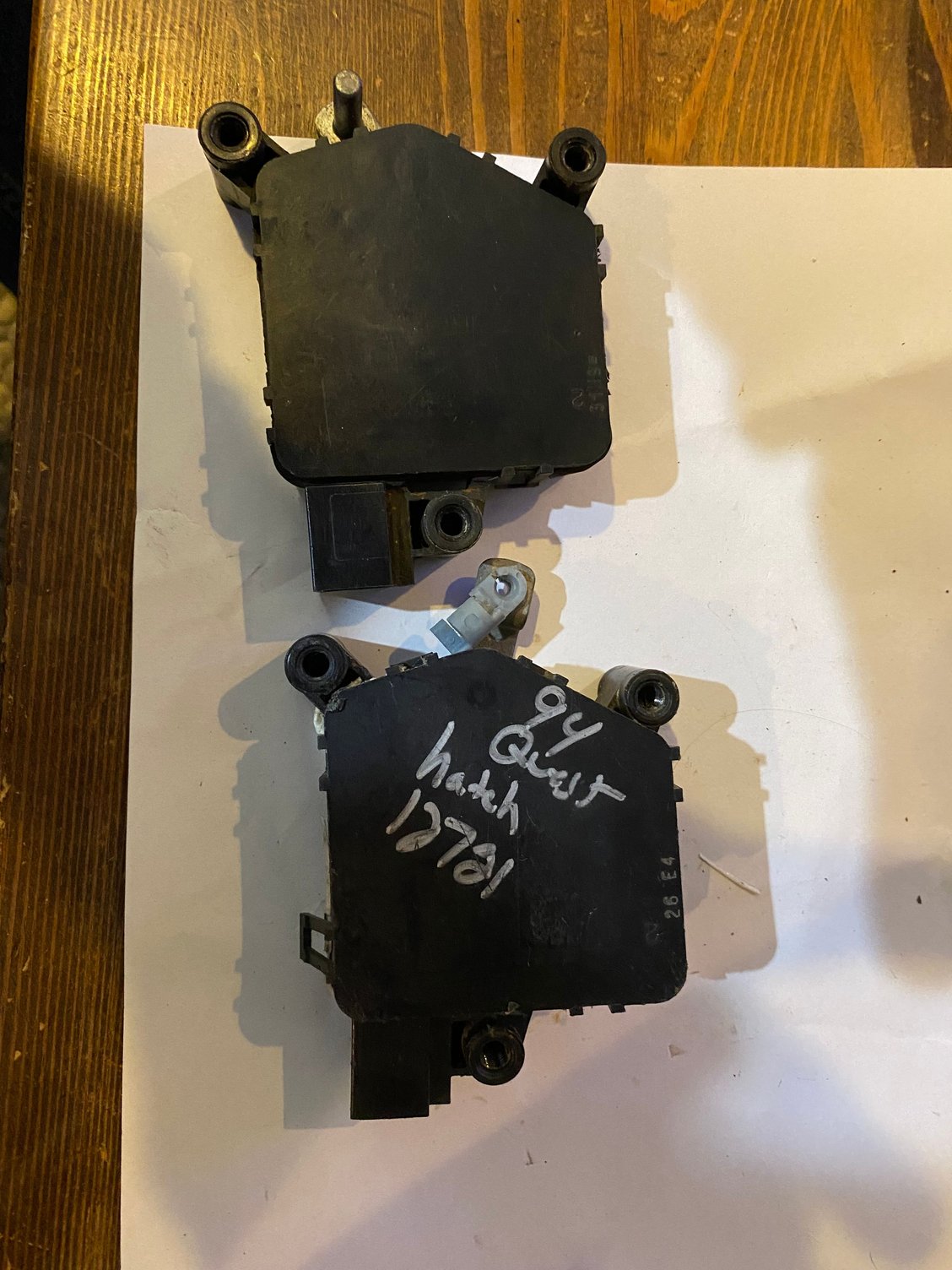

Just wondering if there is a cost effective alternative to the reverse actuator for my newly acquired Xpedition? It didn't have one when I got it so I was wondering if there's a fix or replacement part for it. From what I've researched they don't make them anymore.

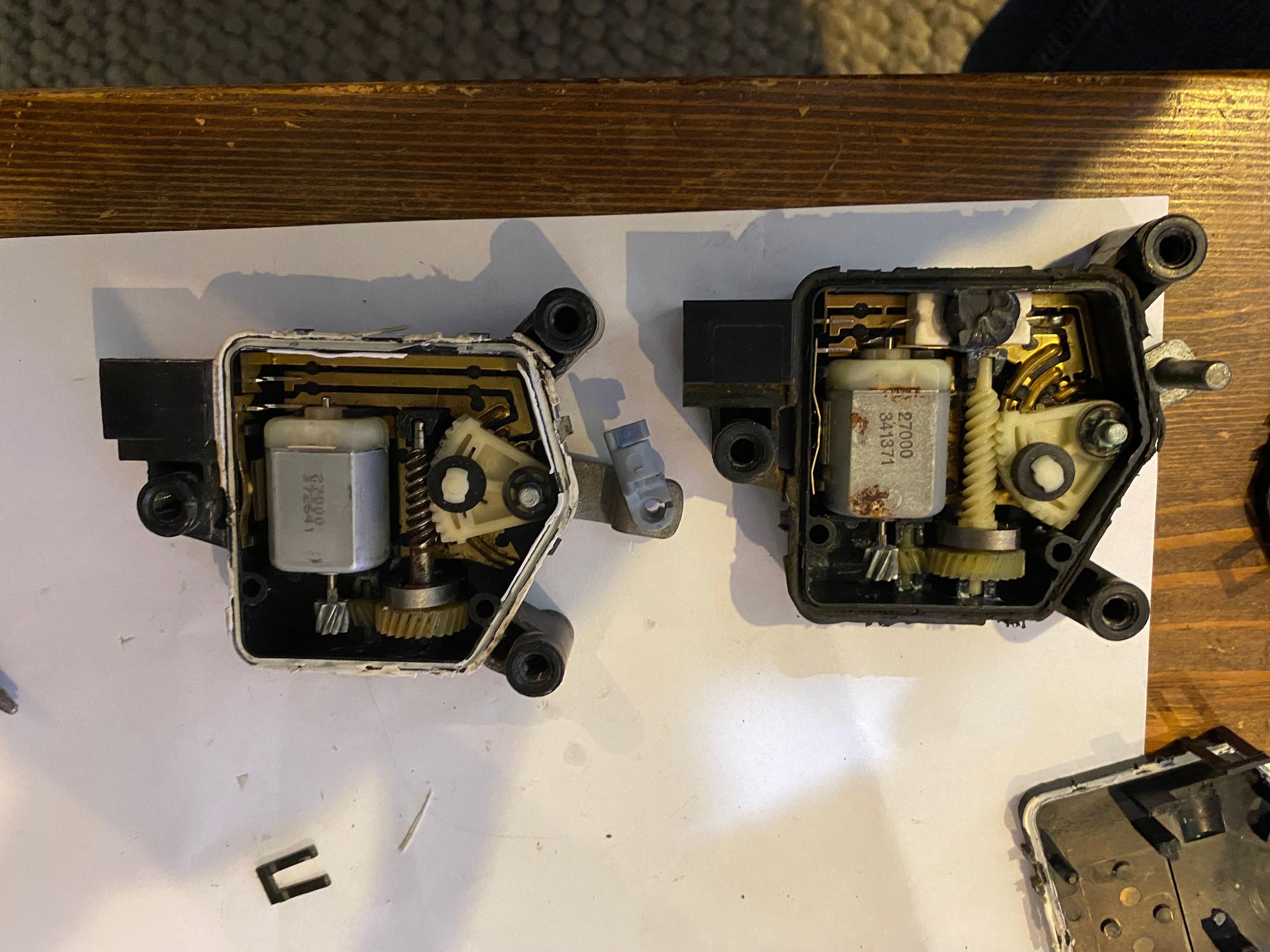

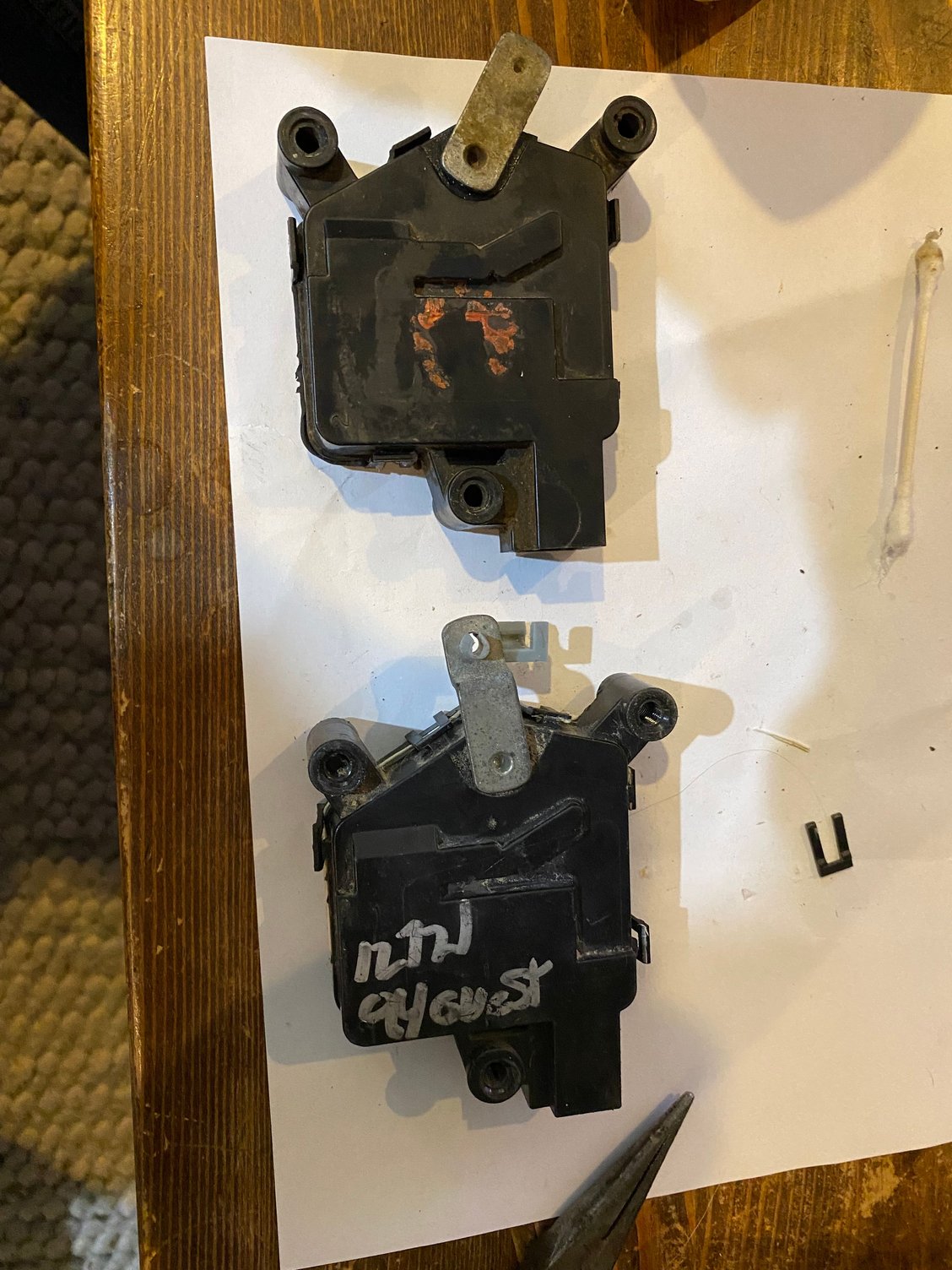

94 to 98 Nissan Quest rear door lock actuator from junk yard $20.00 ! Pull motor from Nissan actuator , and put it in the Polaris actuator. Let me know if you have any questions! If it is not the motor, then solder diode or resister from Polaris actuator into the Nissan actuator, The resistor is a limiter . I do not know the technical name but it is the difference between the two actuators!
Mossman
