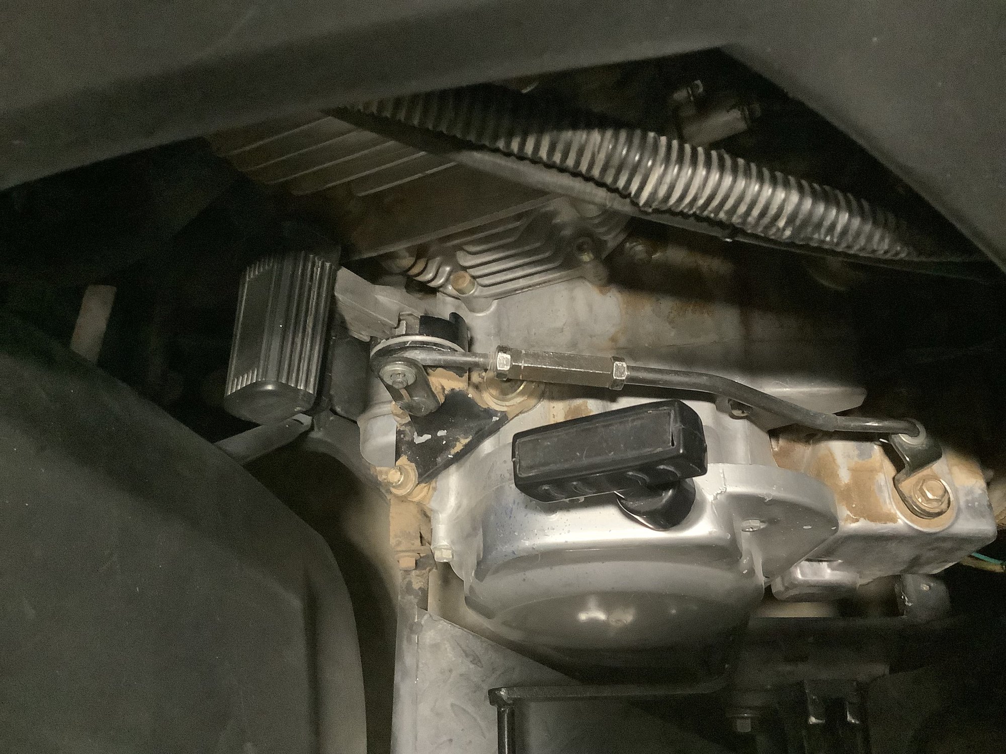

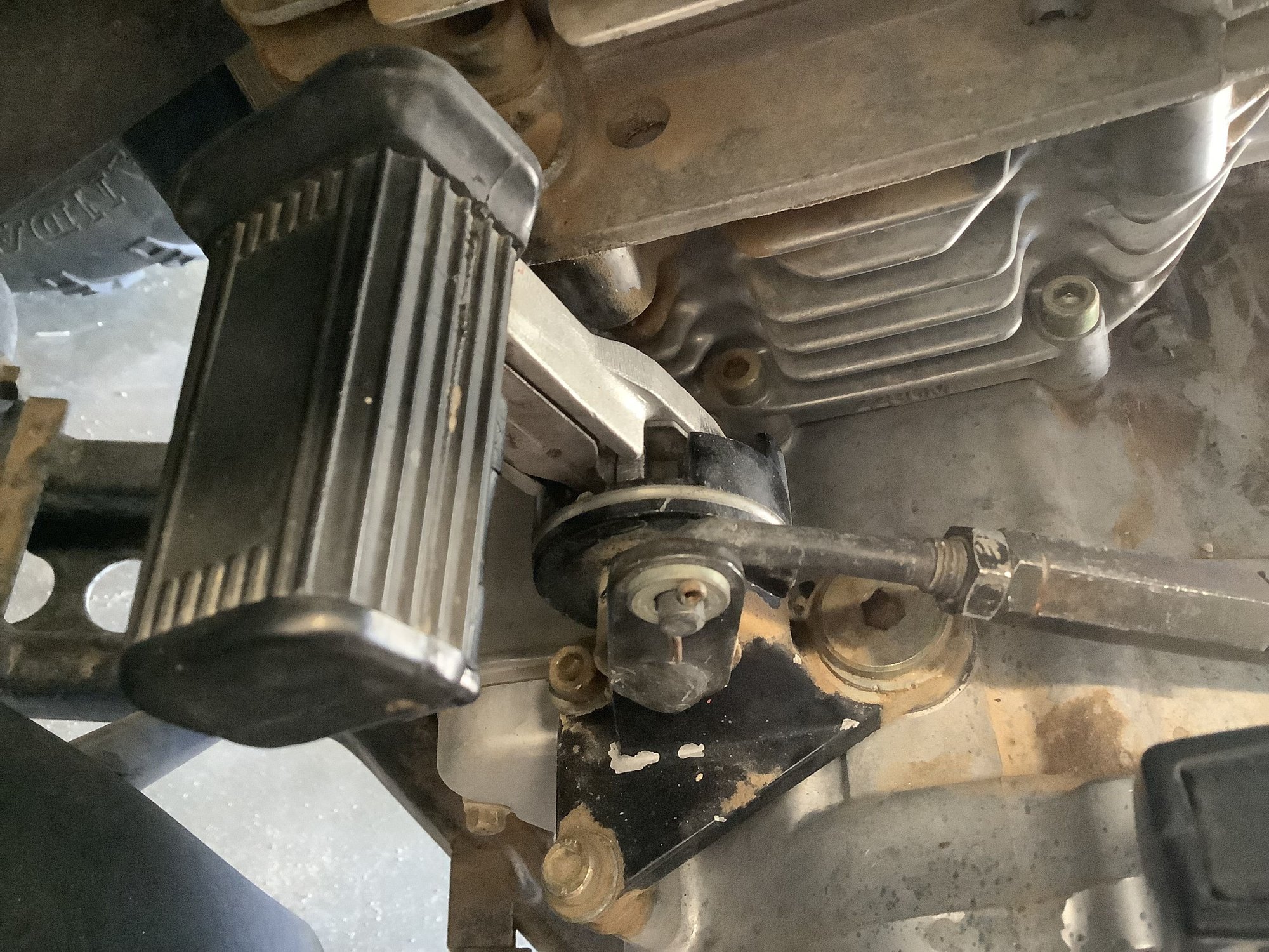

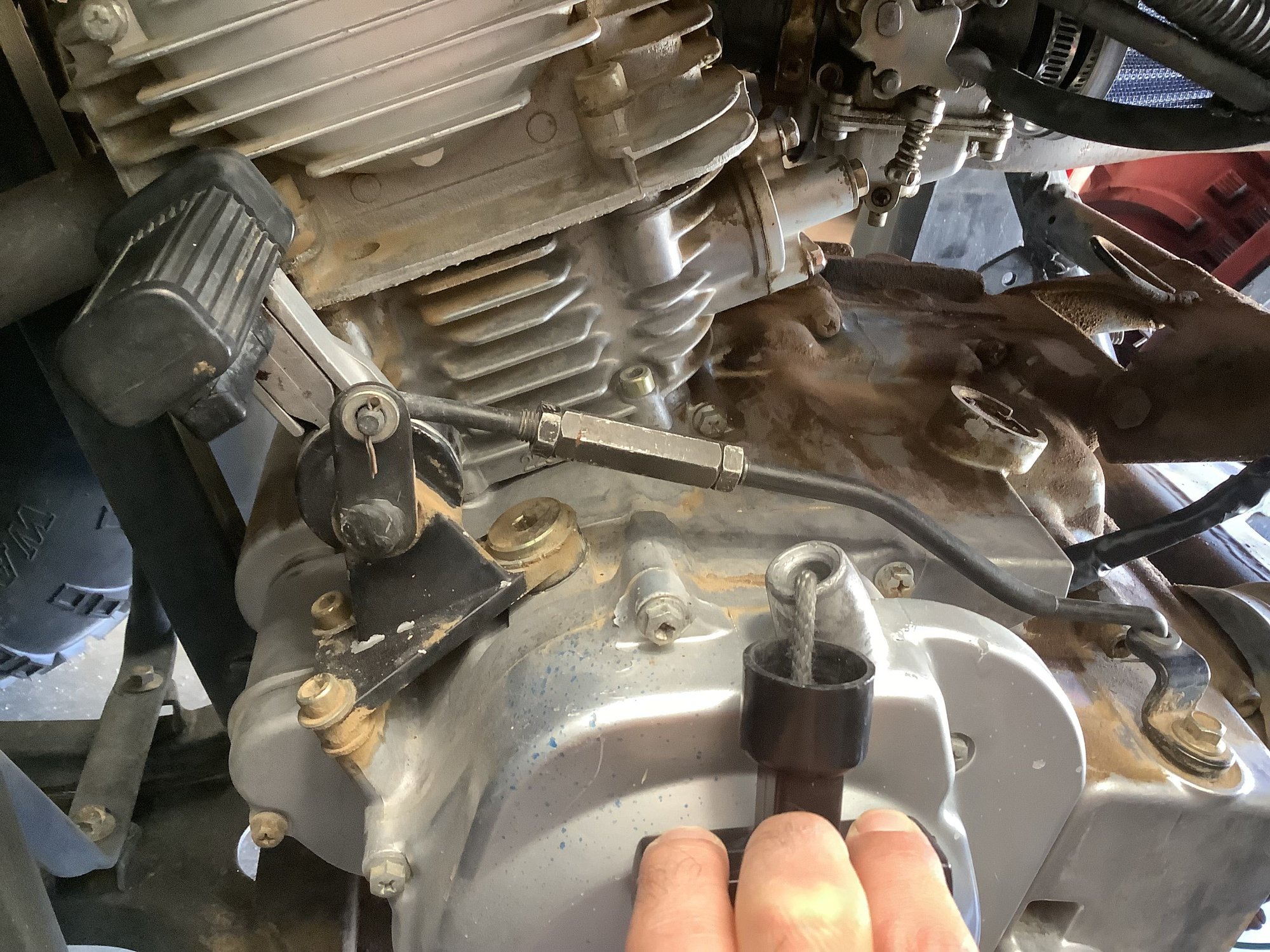

I adjusted the linkage from this:
To this:
