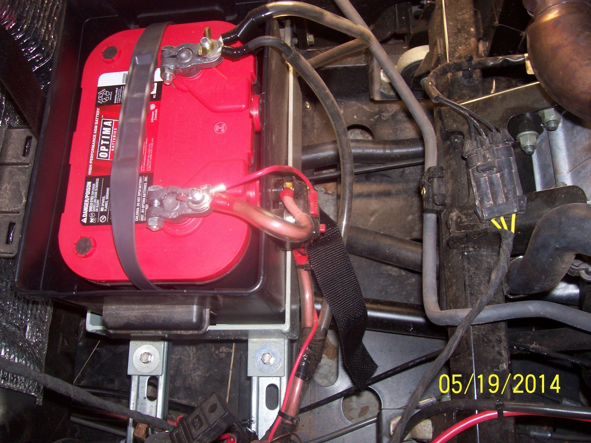

I've never seen a larger statot / upgrade for these , my brother in law has a ranger 6x6 and had same problem , I made a bracket and installed a full size Optima battery , no more problems . If you do a lot of plowing just put a trickle charger on it when you're done .

This is what I put on my Ranger 570 when I bought it , still working great .
