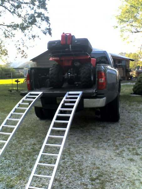

I am wondering if the tail gate cables on my 2009 Chevy will be strong enough to support the weight of RZR. I will be using aluminum ramps like this:

yes they will, but put a jack under the rear of the rzr (in the bed of the truck) to relieve some of the weight on the tailgate when transporting. this way it will keep your tailgate from getting damaged.

It should. I put my Sportsman X2 (700 lbs. or so with winch) and my 350 lbs. without any problems. Of course that's just loading and unloading.

This is a long bed truck, 8 foot long. I was thinking it would fit all the way in and I would be able to shut the tail gate.

It won't fit. I think the RZR is 102" long. 8' is 96" long. So, it's 8'6" long and will be sticking out of the bed. It may get all four tires in the bed though. You, just won't be able to close the tailgate from what I can see.

you will have to remove the tailgate, but it will work. i have a rzr s and load it in a short box once in awhile.
