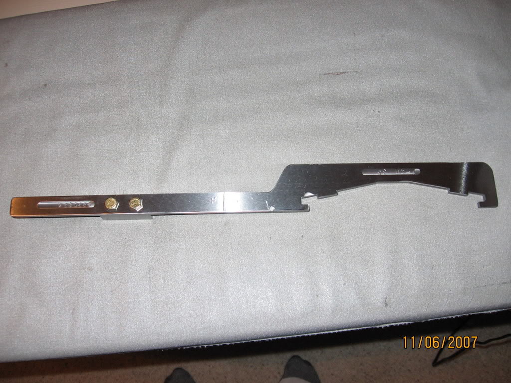

And here is the clutch allignment tool that I made. Name:  IMG_0905.jpg
Size:  170.5 KBName:  IMG_0898.jpg
Size:  157.0 KBName:  IMG_0897.jpg
What do you guys think?

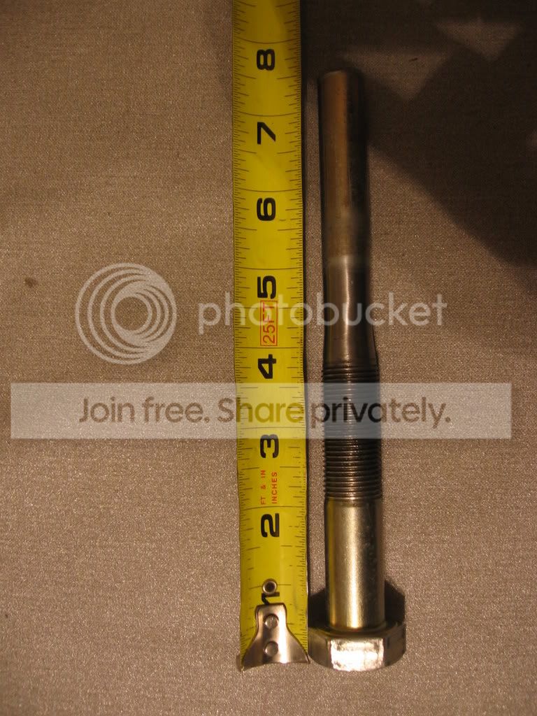

yeah its nice to have access to a machine shop. I am only in high school. I am one of the top ones at the school and in the area in both autos and metals. Most of the time I am out smarting the teachers. [img]i/expressions/face-icon-small-cool.gif[/img]
Here is a pic of the clutch puller with the dimensions. The thread pitch is 3/4-16 fine.
