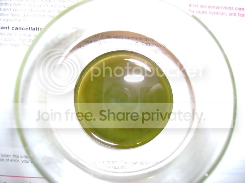

no the oil does not seprate. ya its low for sure and if there is a real runny green bighter color then its antifreeze. unless some one put the wrong fluid in the wrong spot. if it has antifreeze in the engine dont keep running it for sure.

<div class="FTQUOTE"><begin quote>Originally posted by: stendori
no the oil does not seprate. ya its low for sure and if there is a real runny green bighter color then its antifreeze. unless some one put the wrong fluid in the wrong spot. if it has antifreeze in the engine dont keep running it for sure.</end quote></div>
Thats what I was thinking, My wife said the oil should float on the antifreeze but that is not the case with my sample so I don't know what to think. I am only listening to the wife on this one cause she is a chemical engineer. My oil level when checked with the machine warmed up is allmost all the way up past the twist in the dipstick.

caper on your quads, you actually have an oil tank, the 800's are a wet sump, just to clarify. i would take it to the dealer, and see what they think. tell them you want a comression and leakdown test and you want to see the results.

Compression and leakdown test, got it. They should warranty that right?
My owners manual says to park on level surface, wipe the dipstick clean, reinstall the dipstick completely, but do not lock it. remove and check the oil level. It does not even mention running the machine.
Some shots of the seperation

Yes you can see the differance for sure.........You should show the dealer these pics!!.........Caper.........I can pour some oil in a glass tomorrow and see if there is any color differance like your showing....After it settles...How long do you think that took after you poured it for the color differance?...............Caper...........

Wow I would really appreciate that caper. Give it about 2 hours thats about how long mine sat undesturbed.
