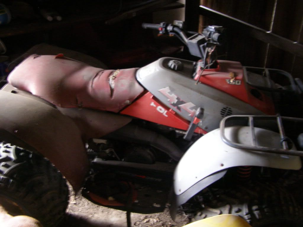

gee's i'm sorry its a 1993. hope pic works it's red and gray think it's a trail something.
http://i287.photobucket.com/albums/l...M/P0000042.jpg

they only made the 350 in 92 and 93 i think and switched from 348cc to 378cc and called it a 400 most parts will interchange between the 350 and 400
tire size stock is 25x8x12 front
25x11x10 rear

It is a two stroke engine with oil injection. I had a 1992 350 liquid. Same color as the one in the pic. Was a good machine for the miles it had (4500) or so. Check over the chains (all 3) sprockets, bushings counterbalance oil............Get a repair manual for it, chances are you will need it down the road. When you get it you could change the front hub oil, air filter, counterbalance oil, grease, clean, tighten/adjust chains......just my 2 cents.
