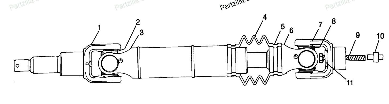

If you have the old 97/98 rear drive shafts,slide hammers, air hammers,Liquid Wrench,PB Blaster,etc and heat can help. But on some about as easy to remove the other drive shaft(if you can) and knock the damaged side out with an air impact through the rear of the gear case. Hard drive shafts to remove when corroded and frozen.If you have to remove the other shaft,when installing both back on,you have to go from side to side to tighten both drive shaft bolts into the spacer evenly.(item#10) Always use anti-seize on the splines on the new one.
Attached Thumbnails Broken Yoke?  Brother in law telling a fib?-def2c1c666575a831b399ab51d6edec2fb97628d.png
